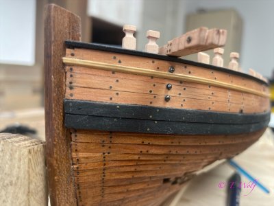

Good morning Oliver, it's nice to see you back at the shipyard. I'm glad to hear that you're feeling better after your surgery and that your recovery is progressing. My experience with dyeing: At Le Coureur, I treated the Wales with Clou stain, and the result is a deep black.
