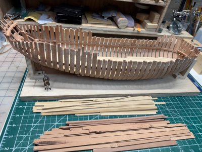

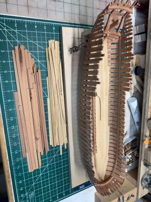

While doing other projects, I took the opportunity to review Adrien’s book and realized that I was tapering my stern ceiling planks way more than they should be.
Per the above photo the planks don’t appear to taper at all. My error was that I scaled the planks from the drawings on plate 6 and 7 not accounting for the two-dimensional aspect of the drawings. :rolleyes:Cautious
Anyway, I’ve spent the morning removing the incorrectly tapered planks and will now try again…
Two steps forward and one step back! Tomorrow I’ll start replacing the planks I tore out.

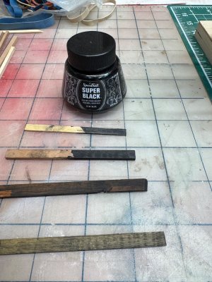

I played around with various methods to ebonize my wood to mimic ebony. Various wood dies and stains have been disappointing but using India Ink seems to OK.
I’ll try a few more samples and may simply need to find a US source for black hornbeam… we’ll see.

I also used black ink to tint wood. Be sure to not only test the color result but the way the now black wood interacts with adhesives. I ran across some where the black leaked into wood glue making an epic mess. Somewhere on this forum is a discussion of the different inks and why they perform differently but I haven't the foggiest where anymore. I ended up using a waterproof ink by Dr. Martin...
