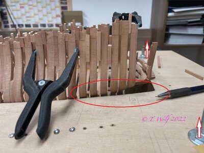

Ok yes but your work is great for someone who is just starting scratch work. I was looking at your board you built. You used the Tee slotted aluminum and wood. Is the wood slotted for the alum channels ? I suppose this can be used for any future builds also ? I've seen a few built like this. Is there any particular way to build it or size ?
Oh I see it now yes. its slotted. Couldn't the tee slots also be used to hold the rods for the upper portion of the jig ? Also Ive seen some jigs where the top stays flat with no curvature and others where it follows the curve of the wale. Why does this differ and what reasons are there for using either flat or curved ?

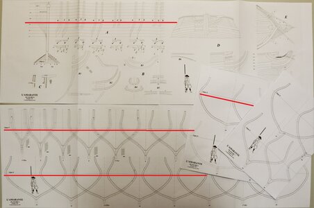

Toni you are right, the board is 125cm long and 75cm wide and should be usable for other boats. The top frame can be straight or curved, depending on what you want to go by. In my case, I followed the waterline which is also shown in the individual plans of the frames. In order to fit the last frames towards the stern exactly, I also adjusted the board slightly upwards because the gap becomes too big.
In the case of L' Amarante, this is line 9, which is also the widest point.
Ok yes I see. Adrian has specified which line to use also in the book. Getting this right is very important. I wont worry about even building the jig until I'm well into the frame building process.

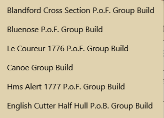

so, here is the list that we have so far (taken from the Navigation Bar)
