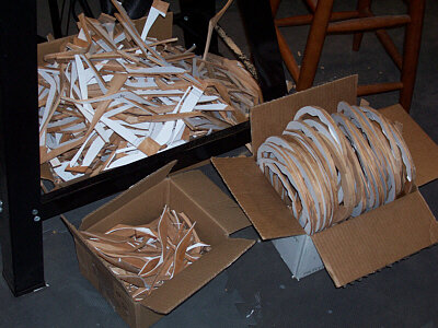

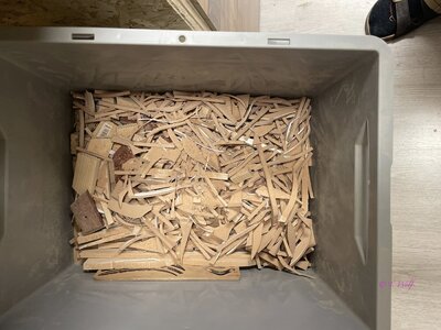

... look at the picture below... (sorry about the size/quality of the pic, digital cameras weren't nearly as good back in 2007 or so).... the white box of frames to the right generated those other 2 boxes of waste... ugh...
but you can make a very pretty hull the Hahn way, I have to say...
