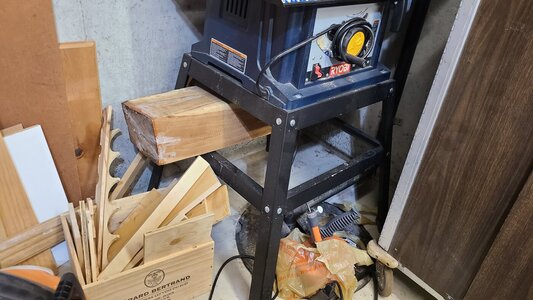

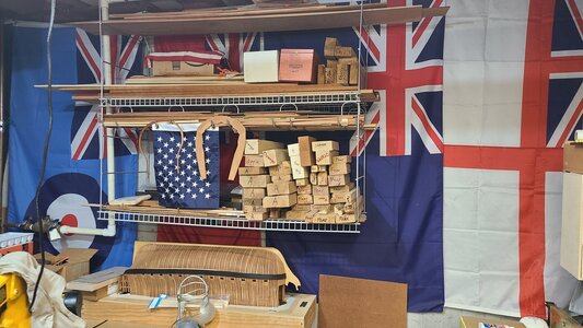

I will be milling my own wood... from my supplies... Mostly cherry for the hull and apple for bits and Bob's... I usually go downtown to a commercial supplier and get 8ft. boards in 1/4 an 1/2 inch and then mill down to needed sizes. I might tap into this old cherry log that's been seasoning under my table saw for the past 10 years now.
I will be milling my own wood... from my supplies... Mostly cherry for hull and apple for bits and Bob's... I usually go downtown to commercial supplier and get 8ft. boards in 1/4 an 1/2 inch and then mill down to needed sizes. I might tap into this old cherry log that's been seasoning under my table saw for the past 10 years now.
Yes, that’s the way. I’ll buy 6” wide planks of the thicknesses I want but mill it down to what I need. Having slats or strips milled would get expensive. You cut down thicknesses on that saw ? I find when it gets below 1/4” it just doesn’t stay true. Maybe a double fence or feather board would help this ?
Depending on the piece of wood I use a Band saw, Byrnes saw, Byrnes Thickness sander, or a Planer... in no particular order... The thickness sander the most though. I rarely use the full size table saw, it's really just too big and wasteful for the sizes we need. A band saw and thickness sander are much more precise I think.
Ok yes. I’ve milled quite a bit but the pieces didn’t have to be spot on. I had a 10” it broke so I bought an 8”. Just can’t get small stock accurate enough with it. Yes I agree we need the smaller saws for the smaller stock for models. I’ll be picking up 4” from Micro Mark, Proxxon clone. I have the small Proxxon 2” and for very small parts in thin material with the carbide blade it’s ok but it really barely worked for my milling of wood for my Blandford section. Wasted alot of time using it as it’s so weak.
