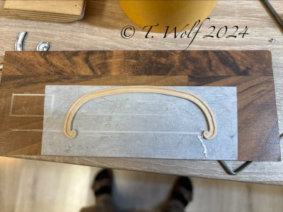

today I didn't feel like working on the construction site on the ground floor and hid in my workshop. Some time ago I had prepared various parts which I attached today.

For the two parts I used 2mm thick ebony and 2mm boxwood. I glued the boxwood decoration to a board with double-sided adhesive tape and carefully milled it with the milling machine. Then I reworked it a bit with the Dremel. In the next step it was carefully removed and placed upside down on the board and milled off. Finally I sanded down the decor with sandpaper until only the edge was left.
The ebony base was made from three parts. Both were glued together and after drying, the thin boxwood decoration was cleaned of any residue and polished with steel wool. In the next step, the ebony was also fixed to my board and milled down so that I got a total thickness of 1.25mm.
