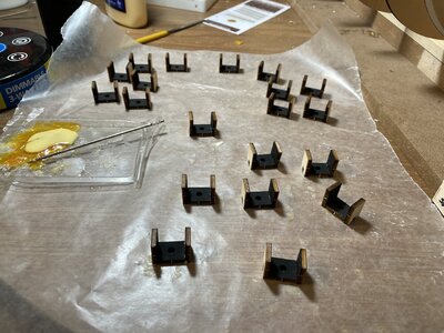

I’m hoping this exercise will help keep the boxes from breaking off or coming loose. First, I glue on the back side with Titebond II Premium Wood Glue after marking where they would go on each side. Then I drill holes from the front side inside the marked areas. Finally, I place the tips of wire into super glue and place them in the pre-drilled holes. I’ll cut them off later. image.jpg
I’m hoping this exercise will help keep the boxes from breaking off or coming loose. First, I glue on the back side with Titebond II Premium Wood Glue after marking where they would go on each side. Then I drill holes from the front side inside the marked areas. Finally, I place the tips of wire into super glue and place them in the pre-drilled holes. I’ll cut them off later. View attachment 248042
That's about the only thing you can do.

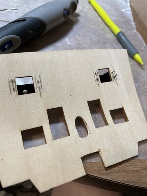

I just wanted to advise you to expand the hole under the bowsprit.Then sheathe the bulkhead with slats anyway.I also cut the bulkhead at the bottom to get a curved shape.
So I did cut the hole and trim things. It seems I’m not the only one who did that. Is it a design fault or operator error?
