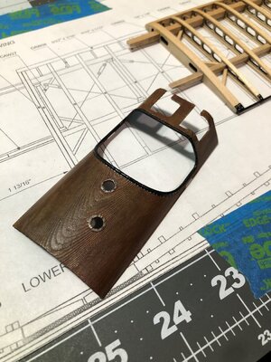

I love the wood structure on the cockpit panel. You could design it that way or is that an additional advantage of the printed layers?
Thank you Peter, we set the part orientation on the printer to make the layers like wood. I If I was to paint it a solid color, I would make it smooth. ;)

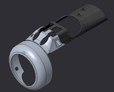

Dean the 3D printing looks very good. What was the kit solution for these parts that you had 3-D printed now?
Thank you Heinrich! They are not provided in the kit. It is a bare airframe as shown below...
I am adding the cowling, machine gun cover or cowling, and the cockpit wood panel. I am still leaving the sides open. I just wanted to add some of the more identifying pieces that make the airplane more recognizable. ;)
So I am adding these three parts...
