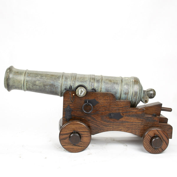

I stained the carriage that I made last night....didn't turn out too good. The dried glue off set the stain. So I pre-stained the pieces before I built the second carriage. Much better results. I also did some minor work on the guns, cleaning them up and drilling the bores.
20210416_154817.jpg20210416_154827.jpg20210416_155015.jpg20210416_155944.jpg20210416_155950.jpg20210416_160608.jpg20210416_160752.jpg20210416_181221.jpg20210416_182255.jpg20210416_183058.jpg20210416_183156.jpg20210416_183253.jpg20210416_191518.jpg20210416_191525.jpg20210416_191938.jpg20210416_195038.jpg20210416_195056.jpg20210416_195114.jpg20210416_200640.jpg20210416_200757.jpg20210416_200824.jpg
This is what I am using for my cannon carriage ideas:
