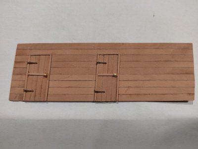

Can find any doors or brass hinges surely these are included

The making of these were planned to use the strips from the PE sheet. There were mentioning of this on page 70: "STEP 58 - WELL".
But yeah, as this page you shown is on a more previous page, this may do raise some confusion.
I have attached a image of the hinges on the pilot model, they were in a slightly different fasion by the idea of making it would be similar.

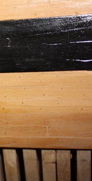

I'm sorry for not including the nails in, the nails should be made by brass strips cut and inserted into the planks/parts. The kit have overall potentially over 10000 nails like this: https://drydockmodelsandparts.com/products/tiny-nails-0-3mm-200-bag, and including them would be hard.
I cannot reveal here the cost for producing these nails, but they are sadly not cheap, so a good and affordable option is to use brass strips.

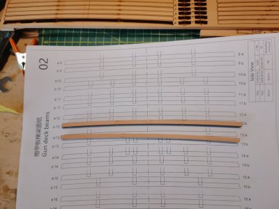

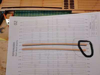

The reference of the deck beams were physical drawings instead of illustration on the instruction. The beams were indeed no longer sandwich style, we did this to make the beams looking more authentic. In beams were not in sandwich style in reality, and to make them that way would cause a clear separation look. We gathered feedback from the Blandford and early release version of the Enterprize in China, many reported that it was not a good style, so we have changed the fasion of the later version.
The deck beams are not hard to make, there were physical drawings of the beams provided in the kit showing all the grooves and where they should be cut. Each beam have a reference, "a" for bow side and "b" for stern side, mark the grooves and cut them, then the beam is done.
Here I included a image from British National Maritime museum - https://www.rmg.co.uk/collections/objects/rmgc-object-67757
This type of beam could be achieved by using the current method we provided, but not the sandwich style we used to. Second image was the early pilot where we used the sandwich style.

Its difficult from the instructions to know exactly where to place the various deck parts So everything lines up later
Most of the KIT is Amazing like the frames
LOwer deck beams are great - why not do the same for the upper decks
Its just so disappointing that you have no explanation about the way it is built
I think on your next model you need to put explanations in like you have above

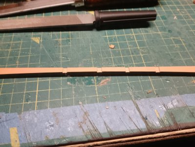

Ok - so removed the edge of D1/D2 and notched it its very easy
Liierally cut the sides of the slot and flicked out the bit between
THeb cleaned it up with a File
But getting the right position and depth would be useful
May i suggest that you mark the next model
It MUST be in the instructions so we know where we are going

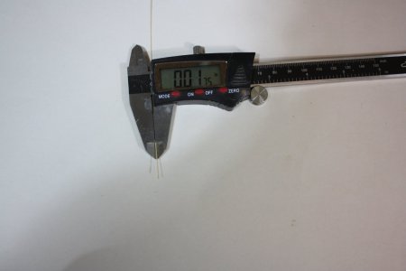

Are you writing about treenails or iron nails? If the latter, where would you use them?
Iron nails. I ordered square small shoe nails for steps, knee arms, anchor arms, capstain itp and micro brass nails for attaching door hinges itp. Just small model detailing, in 1/48 its look amazing.
if you want tree nails i use small thin square strips

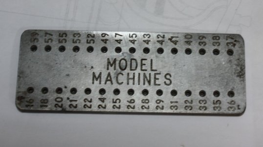

I pull it through an old tobacco tin from 50 tears ago 7 or 8 different sizes of holes an pull the wood through successive smaller holes

REally Confusing D1 and D2 are 1 LOWER deck
D3 and D4 anre different DEck GUN DECK
Which explains why they are different at ends
Toook me some time to work oit as the first illustation of how they are built id GN DEck
THink ki am ok now!!

Interesting solution and I am guessing they would look great. Hope you post some photos when you get them. I have always just gone with copper wire and made nails as I can use these as is, then once in place and wiped clean with some water to get the filings removed, blacken in place with diluted liver of sulfur as it will not stain the wood. I cannot find any contemporary drawings that show square heads so only used round stock, but would love to see drawings that show the square nails.
Sounds like a nice home made draw plate! I just use a regular draw plate with holes down to 0.016" diameter and my own choice of wood at these small diameters has been bamboo most of the time. Bamboo from skewers at found at the grocery store works really well and the color is very subtle. I slit them to a suitable size then start drawing them as you describe going from the larger holes to the smallest required.
now ive got over the notches not being cut out
Getting the notches cut in the exact right place before the beams are installed is difficult regarding alignment if the beams are not perfectly placed. Many find it better to install the beams, then mark out the notches for the carlings and cut or file a notch so they are properly aligned. Just another way to achieve a perfect result. It is not such a big deal for a cross section model as there are not that many beams and it is pretty much straight line midships, but for a full hull, it can be tricky to have everything lined up.
