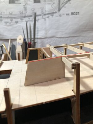

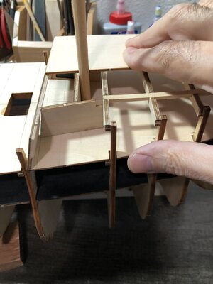

Din62, good afternoon. I watch your construction site with interest. But now that day I cannot understand how the deck will go. Will there be an additional add-on in the place that I have allocated, or is it supposed to be something else?View attachment 268427
Hi Alexander, the picture angle, along with the placement of the wall is causing an illusion to some degree. So let’s look at the issue I discovered when building the wall.

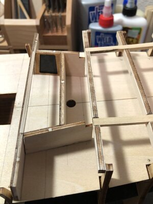

The notches in the side walls are supposed to locate everything from the beam…
The deck planks will increase the height of the wall, and I can sand everything flush and level prior to installing the upper deck sheet. Which will look something like this…

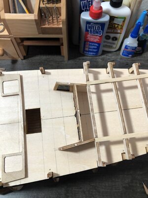

Here is the problem…
Using the provided notches, the wall ends up in the middle of the mizen mast! No good!
So I have to move everything forward as show above. But that makes the furthest wall at the edge of the upper deck, too far out with no overhang of the deck!
So now I have to notch the back of the wall in front of the mast, to allow the wall to move back towards the deck beam. And this will require making a spacer block for both sides to locate the wall properly, because the notches can’t be fully seated! Big mess!
This kit keeps you on your toes…because almost all these walls are at angles, and you have to locate them precisely and adjust them…with some compound angle corners.
The location of the walls are shown to be printed on the deck sheets, but they are blank! So I am using the deck beams, and the deck sheets that go above the wall, to accurately locate all of the walls. ;)

Dean, if I understood correctly, then in the future it will be necessary to grind off as on the red line to get a smooth flooring. So?
Oh boy - the wall across the mast hole is not fun. It makes you sometimes wonder whether some kit manufacturers actually build the ship themselves AFTER they have drawn up the plans and written the instructions.
Yes…once I plank the deck, the wall will sit on the deck. Then I can do the final fairing of the top of the wall with the deck beams. Right now I am trying to properly locate the wall so I can build it. ;)

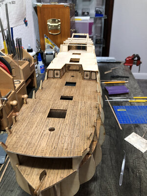

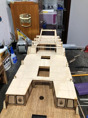

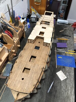

I continue to work on the back wall and have added columns and base trim. Next will be side walls and front wall. My plan is to go ahead and finish these walls like on the lower deck. That way once i plank the deck I can install it as a one piece sub assembly. Then fair the top with the deck beams and add the upper deck, which is the last deck to be installed.
Some pics…
AECAC53A-2F14-4EB9-B52D-00756B5042AD.jpeg4087A51F-DCF1-4079-BE7C-F90DB047900E.jpeg51462CEB-8F16-4321-B222-D18310066B57.jpeg866FDDDD-A53E-4109-8E04-1124E89C83A6.jpeg
Some pics…
View attachment 268547View attachment 268548View attachment 268549View attachment 268550
Looking good Dean

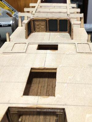

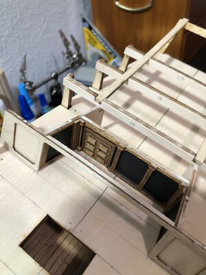

I glued on the front wall. Now to sand and stain and finish with all the trim and panels.
I sanded the panels on the doors in hopes they will match the walls when I get those panels on.
I’m not 100 percent happy with the doors, but they are so tiny I had to hold parts with tweezers and try to bevel the panels once glued on the door. At this point, the only way to improve them, is to carve them …
