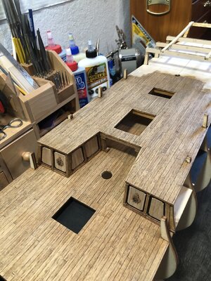

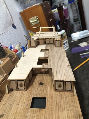

As you know, the final appearance is a process with many steps. But it doesn’t look bad even when first applied.

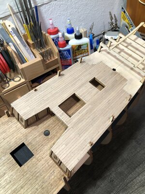

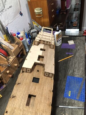

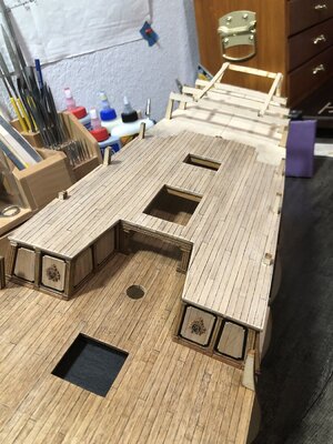

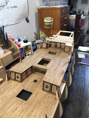

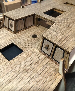

The deck is stained and nails added.

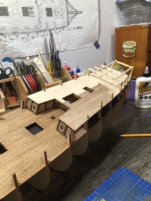

With the wall sitting in place…
Overall view of decks…
I’ve noticed that lighting is a big factor in shade and color. In bright light it looks more grey, and in dimmer light it looks more brown. So the level of the decks will effect the color, due to lighting.
But overall they look very similar, with enough variation to be realistic. ;)
Due to the many steps, there will always be variation. If I wanted consistency, I would first add pre stain. But this is not the look I’m after. I want a slightly used or weathered deck that has been worn with use and age. But not so worn that it looks out of place with the rest of the ship. That’s my logic anyway. ;)7DA20B2C-9E3D-4F6E-A86E-AD161E58B137.jpeg
View attachment 269511View attachment 269512
