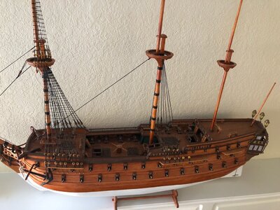

I remember admiring this kit in the local hobby shop way back in 1970's. It must be a 50 year old design.
I build it early 70. the 1st was not laser cut. hard work to hand cut the ship. still have the saw

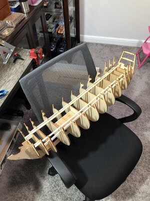

All frames are on the keel finally! Spacer boards up top are a little random, but my only goal was to maintain an exact distance at 3 points (1 on keel, 2 port and starboard up top) within less than 1/2 mm. I measured each one in multiple places along the width as I installed them and they all pass! This is a straight, square assembly! ;)
First milestone…

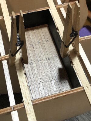

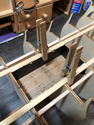

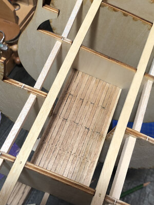

I planked the false deck… as you may know I prefer a dull finish on the deck, with an aged look I get from stain, scraping and steel wool. The idea is if the deck is dull and everything around it is pristine looking, it gives it a more natural worn look, and at the same time makes the other details stand out more. That’s my logic anyway. ;)
Here is the false deck and I will install it permanently next, and put in the side walls and paint them black. There is a set of stairs that go down to the false deck with a railing around it. So you don’t really see much of it.60DA4256-63F6-49D6-A9E7-B2D3FA590E73.jpeg9668DFE6-325E-4AB7-B228-EF58D82F3364.jpeg
