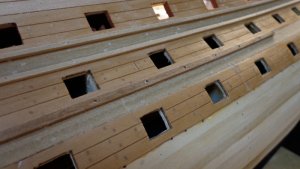

Well, the good, the bad, and the ugly - mostly ugly. Some of it looks fair, but then the planking butts will not line up with the butts on the deck. See the forth image. This is obviously going to look quite stupid. Hence, what I am trying to duplicate with the treenails is the illusion of this being a POF. I am thinking the butts of the hull planking should be matching up (vertically) in line with the butts on deck. Oh well, too late to do anything about it now. This can not be seen or noticed right now as the butts of the hull have not gone all the way up to the top of the hull sides. Just another day in goof - up - land !!! However, the only thing I can say is about the time the rest of it (like chain plates, channels, etc) is added, some of this will not even be seen much or even noticed. I am learning to hate laser cut pieces due to mostly, they are made out of ply. When you start to sand on this stuff, it does NOT take long to sand through the first layer. The wood is darkened a little with the application of Satin Polyurethane. See the last/fifth image. So, I went back and looked over the situation again - some line up and some do not - oh well. I highlighted the white line to show what I am talking about. I did not even think about the treenails needing to line up with the decking butts. Actually, I am not even sure if they are supposed to, but it would look more pleasing to the eyes.

Donnie, the averge admirer(non modeller, that is) will not notice that inconsistency, only super observant people like us will. With regards a mistake, look at it from the point of view of a layperson, will it be seen/noticed, if it is the proverbial boil, then it must be fixed. As with the decks, there is usually a lot of clutter therefore only a small proportion of the deck nails will be seen, so don't feel you've goofed on the alignment, look at it through different eyes.
Granted people will only notice it if the hull is at a certain angle, display it at 70 degrees and less.

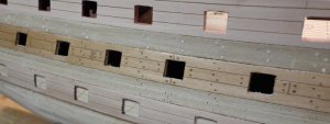

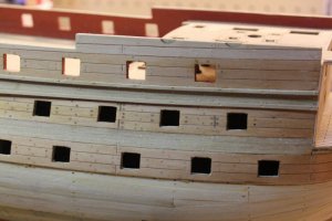

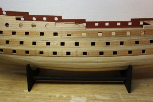

Thanks to all. I appreciate it. Well, I worked through it and got one side done. Here are some pics. I have not installed the extra Wales parts. I also do not know what color to paint the Wales. The box has them natural, BUT the box art is from other picture. The Box art is not using the laser cut pieces, so it must be an old box art. So, I am not sure if to paint the Wales a dark brown or flat black followed with satin poly. Does anyone have any suggestions ?

I have moved on to installing the Wales. I am keeping them natural for now as I experimented w different colors and could not be content with any.
Yep, as you can probably tell, I am treenailing the Wales too. In this situation, there is no way I could think of to hold down the Wales strips while the small amount of glue set up. So, the treenails really come in handy as I could fasten the Wales to the hull immediately.

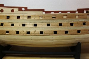

Here are the latest. The upper wales are 2 x 2mm the lower are 2 x 3 mm and as you can see the tones are different. I am using a very small dab of walnut paint that came with box to paint the tips of the toothpicks (for the lower wales only). It takes about 30 min or less to do one section. Not too bad. I have a dremel tool with an extension that I drill the holes. Oh, I am also countersinking the treenails just a tad on the Wales - don't ask me why. Just decided to do it to give some visual contrast. They are spaced at 25mm each which means that in real life, that comes out to be about 6 feet spacing. Again, I just chose at random. This does not coincide at all with the Admiralty "Room and Space" rule for the frames, but hey, it is what it is. Too many holes at this size ??? Reason is that my smaller bits got broke. This captain is broke.

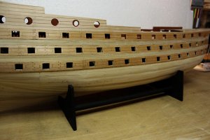

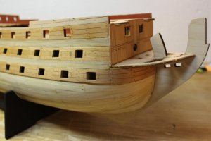

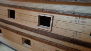

Here's the latest. I decided to stain the Wales with Minwax "Provincial" stain. Once I started, I realized I could not turn back. Then I experimented adding one External Gun Port Frame.
planking154.jpgplanking155.jpgplanking156.jpg​
