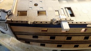

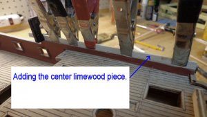

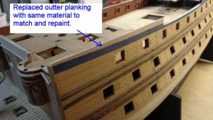

Ok, here's a fairly big problem. This first image is from an earlier image that I grabbed to make an illustration. The point is that the half circles that are already laser cut into the planking are in the wrong place. They will have to be moved fore about 10mm each. This next image shows the rail in place and as you can see it overlaps a lot over the half circles. The half circles are where the round Cannon Ports will go. The following images show the basic step by step of removing the layers of original planking, limewood, and walnut strips. This will be redone and new half circles will be cut out in the proper location. The last two images shows the cutouts are WRONG. I realized later that they are not in alignment with how Cannon Carriages will sit on deck. If left this way, the Carriages would be sitting on the Grattings. The carriages need to sit inbetween the Grattings and therefore these cutouts will be spaced farther apart !!! The Center Railing that has three post will be removed and a longer piece added (made from scratch) -- images at next post will show the final correction.

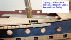

Now on to installing the Railings. I also included a quick video on it as well. The Rail is stained again using "Provincial color stain".

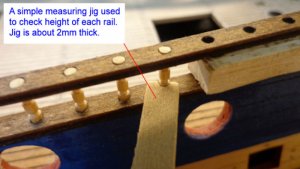

Well, I can't believe it - after all that work was done, (on replacing the upper inside an outside planking, as it turns out, the Round Cannon Ports are in the wrong position - Arggg ! Dang ! Ok, so after looking at situation, (and again, reading far into the manual) and a little observing..........you really have to be watchful for A LOT of things besides what you are focused on. This time, the Cannon Carriages would have been sitting right on top of the Grattings on the Forecastle. I realized this and did a little maneuvering of where the Round Cannon Ports "should be" located. Using that as the reference, I proceeded with mounting the Railings.
On another note, I actually had to scratch make the Railing that is situated between the two Round Cannon Ports. I had to make the railing a little longer and actually had to ADD one more stanction to make it come out right and to look right.
Then as you can see from the image that I used a spacer from the railings that was done and used it as a height gauge for the upper railing next to the Cannon Port. All in all, this part has been THE most frustrating and THE most time consuming part of the whole build. I have worked probably about 6 hours total on trying to get this one section to work out correctly.
Donnie
Great idea of the stanchion jig. The Video gave clear instructions on how to go about making and fitting.

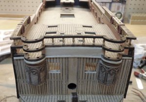

Well, this is it for the evening. This is CRAZY tedious trying to get these curves / angles / and what all to line up good. There will be a half round to cover up the dowel openings. Some trimming and staining, etc. will make this a little better. No parts have been glued down yet. The two center pieces that has the four dowels were scratch built. The original piece calls for three dowels and is too short.

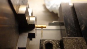

WARNING: Unless you have a lot of experience, please do not do this or try this until you have done a lot of turning. The small arches are done while holding a FILE !! it gets really close to the chuck. So again, you MUST have a steady hand or the file will slip and fly into you. Also, the file is oriented in such a way that while the lathe is turning, it would bounce downward. I can't take any responsibility for any carelessness. The RPM is about 500 which is not that fast. The only risk that you take is holding the round file by hand to make the arches. The file is just barely kissing the indentations to make the arches. Ok, so here are the pics. This first image you will see a tiny orange dot - I am using a parting tool which is 1mm in width. I am making a cut .25mm deep. This next image, the cross slide is moved to the right about 3.4mm and another cut is made at .25mm deep. I follow up both notches with a tiny round file. Final post with stain. At this size, it is very difficult to get them exact. It take a lot of patience and not get in a hurry. At some point, I might try and produce a video on this.

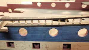

Thanks Eric for the tip. I will have to try that when I have a hack saw blade handy. I went ahead and so far have made enough post for the rails. Here is a pic of how the look so far. The only thing is that I am not sure to leave them natural or paint them black (I had tested black and looked pretty good). Once I got a system worked out wit the lathe, they went pretty fast. These are NOT glued in yet. Trial run.

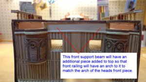

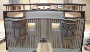

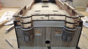

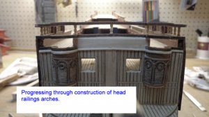

Continuing with construction of the upper railings. As I progressed to the front (head), the upper railings need to match the "arch" of the head. So therefore, this was taken into consideration. As you already see that I decided to continue with using lathe to make the post more decorative.
