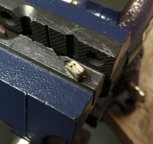

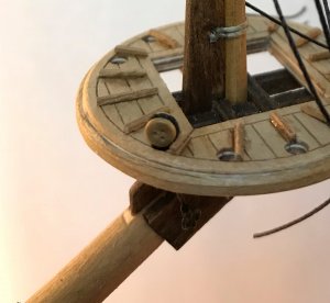

Here's an attempt to try and show how I managed to rig a block for the anchor pulley. I just show a basic step by step of how I used annealed blackened wire to do this. The block is 7mm x 3mm and the annealed wire is .58 mm. The drill bit is a .90mm so that both ends will fit into hole.

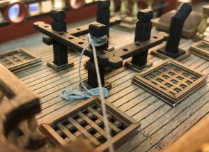

I do not like the rigging line now that I have started to use it. Now, it does not have any fuzzies, BUT, it also will not take on beeswax. Which is very difficult to form things like rope laying on a deck. The OcCre rigging line on my Trinidad was much better as you can form it to any shape and it would stay.

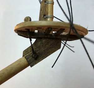

Thumbs-Down ahhh - I just now see in one of my images that the serving on the tip of the Anchor Stock came off -
Thanks Guys. Well, my little point and shoot camera is busted. I have a Canon T3i and actually, in this case, the little point and shoot does better. That is bc the P&S has a macro mode of which I can get up really close. So, I tried my iPhone. I got aggravated at the whole thing and ran short of really showing the steps involved. Sorry - Maybe next time, I will show better or make a graphic on how I did it. The manual wants you to twist the wires. Looks totally fake.

Hi Donnie, just going back to your anchor stock and seeing that the serving came off, this is what I do; I purchased a small tin of DOPE, no not the stuff you smoke(d), the stuff we used to put onto our tissue based model airplanes, it works fantastically on the ropes, it will not only 'glue' the rope to the timber but will also shrink the ropes making them tighter.
For standing rigging that is a bit loose, didn't want to tighten it too much for fear of breaking something, the DOPE will tighten the rope to a certain extent.
A word of warning regarding the DOPE or Airplane DOPE, it is heavily laced with ACETONE, people with lung problems should not use this indoors or smoke near it, in fact don't use it indoors PERIOD!.
......Awww Shucks - ROFL
thanks Eric. Seriously, I appreciate the tip. Now, just to find some.

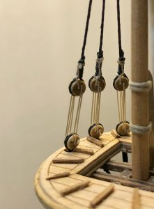

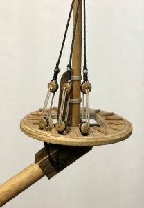

So, here is the latest. I am waiting for a special "Downcut Endmill" for wood that is 5/16 or 2mm so that I can mill out extra on the wooden Axels of the carriages. In the meantime, I thought I would try rigging these lanyards.... my gosh, it has been almost 2 years since I did this. The deadeye is not seized just 100% correct and the lanyards are "fair". However these deadeyes are terribly small. I mean ----- really small.
