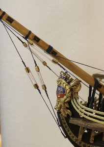

Thank you Fright and others. I appreciate all the likes. I am going to post a few more images on the steps of how I am rigging the other side of the bowsprit tree.

This rigging line that came with box is more like a polyester and is not cotton. In some regards, it is good as it does not "fray", however, the bad part is that it has a mind of its own since it was wrapped on the square plastic holder ( I hate it when they do that). They should all use a round card board tube. I prefer cotton as I can use beeswax. The beeswax also is great when tying knots as it "stays put". Not the polyester. It does *not* like beeswax and I have to put a little CA on the knots to make it hold or it springs back !!! Thumbs-Down

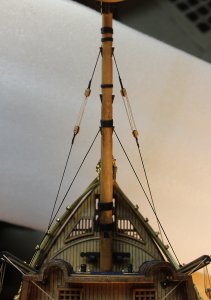

I should be finishing up the hull by installing cannons, but I got side stepped on completing the rigging on the bowsprit. Horrible pictures. I miss my shot box and my point and shoot. I hate flash as the Admiral talked me into using flash - (you know - to avoid an argument)

Absolutely brilliant job on the rigging. Its look so authentic, I can almost smell the salty air on my face.

I really do appreciate the feedback and comments - they are taken with a lot of humility. I really do not like the rigging line that came as it seems to be all polyester and is shinny ( it needs to be dull and not have any shine to it) - it also has too much "spring to it" - beeswax does nothing to make it straight and flexible.
However to those that do not want the fuzzies, then this is your ticket. The line has none ! But, it is a pain in the butt to use...

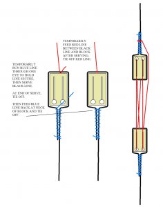

On another note (cameras don't lie) and I see some things that do not look that great and one of them is that the block seizing needs to start closer to the block. I have an idea how to correct this, but it adds to the complexity.
Well, here is a diagram of what I am going to try next to get better serving. Earlier I had said seizing - I meant serving.
