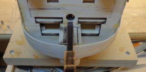

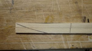

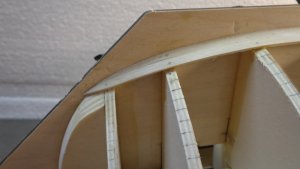

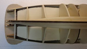

According the pictorial instructions, the Planking will only extend down to where the Bulkheads meet or join the Keel. Except for the aft most at stern, the planking will extend "into" the keel some. The RED line shows where the Planking comes to an end.
Thanks for all the help. Oh, I show just for reference my first tapered plank at the bow.

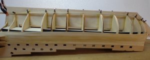

Hi Mongrell - great to have you here on SoS. Thanks again for everyone stopping by to look. Cleaning up latest planking and doing some sanding to see how things are shaping up. I think pretty good.

Don't know about pretty good Donnie? Looks very good from where I am sitting. The San Filipe looks to me like the Pearl's big sister, similar in many ways but more complicated.

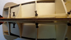

Well, on with the latest. Easy to get bored (board --- ha ha) ,, so I decided to work on planking next to Keel. This particular plank is NOT the Garboard Plank, but I am using it as a reference for the Garboard Plank. Probably doesn't make much sense, but oh well. It is what it is as I say.

Makes sense to me Donnie, if you fit the plank that will be next to the Garboard strake, you get all the spacing for the Garboard ;-) My Pearl kit is quite basic really, the one Frank has is a larger scale and much more complicated.

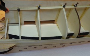

I am installing the Garboard plank and the one next to it.
2341723418
23419

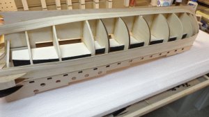

On with more Planking - nothing major to report. This is a double planked hull by the way.

Looking good Donnie. Seems like we may have been doing exactly the same thing today, I got a couple more of my 'bottom' planks put on. Same with my build, nothing much to say about it, other than carry on as before, the gap between the bottom and side planks is slowly shrinking.

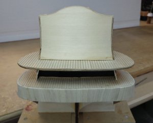

You should clear the left and the right of the keel at the stern by at least half the thickness of the plank .
Lower keel should be left untouched. Otherwise, you will have trouble getting the right thickness on the back

I do very much agree with Mustafa on using those spring paper clips for your hull planking, they do a great job and do not leave any holes to contend with later, ENJOY.

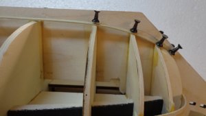

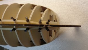

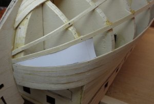

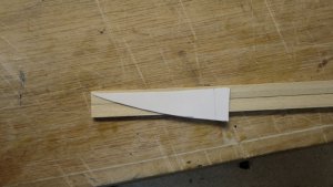

Thank you GemmaJF, JScolum, Paul and Lawrence for watching and support. Here is the latest on the planking. Realizing some mistakes....oh well, it will be covered up by the main planking.
I made a template out of some stiff paper - I also realize that I should have filled in the bow with balsa - but I am making it fine so far I guess.

You are doing a great job Donnie,I am quite sure that the second layer will be perfect.
Looks fine to me Donnie, I think the bow blocks made life easier for me on the Pearl, but it looks like you are getting by fine without them. :handgestures-thumbup:
