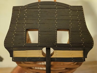

Hello Shota, it would have been better to use the following drawing from the plans, showing the layout of the wooden planks. I don't know if the bottle's orientation is correct.
Tobias my dear friend
Thank you very much for the clarification and guidance. there is no doubt that you are right.
However, in practice the width of the boards as shown in the drawings you attached, makes it difficult to adjust them to the contour of the stern deck and in general.
That is why I chose a width of 6 mm. If we look at the picture I attached from Giampy65's work, we see that he also did not adhere to these drawings in terms of the width and continuity of the longitudinal lines with the pear wood planking, but adapted them to the practical ability and suitability for the hull of the ship.
we can see that the entire black surface is decorated with carvings and the lines connecting the trees are very close and will hardly be visible in the finished ship with the boxwood carvings.
Your comment is important and will help me in the future in maintaining the lines of the decorations and in general, and for that I am grateful to you.

Z uporem maniaka będe pisał piękna praca Shoto . Jakiej grubości drutu mosiężnego używasz do robienia kwadratowych gwoździ?. Pozdrawiam Mirek
Witaj
Mirek, mój drogi przyjacielu Dziękuję bardzo za wytrwałość, w tym przypadku użyłem półsztywnego drutu mosiężnego o średnicy 0,4 mm.
Dear Mirek, Thank you very much for your patience. In this case, I used 0.4 mm semi-rigid brass wire.

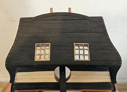

good evening my dear friends
a little update:
To proceed to the next stage, I made sure that the window frames were adjusted to them and I also completed the nailing work on the rear gallery of the stern.View attachment 518361View attachment 518362
Your are putting a lot of time and energy into that black&brass, Shota. Looks nice, all the different wood tones.
