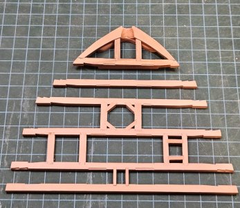

Good evening dear friends
In Last week I worked on preparing the crossbeams that support the upper and front decks at the bow of the ship.
This time I decided to combine local pear wood alongside the European pear. The local pear wood has a brown shade close to chestnut.
most of the milling work was done on the Proxxon MF70, since I haven't yet learned to work with the 4-axis CNC, it takes time to become proficient.

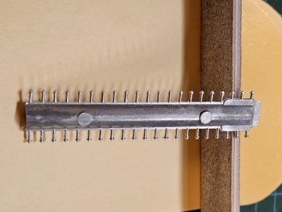

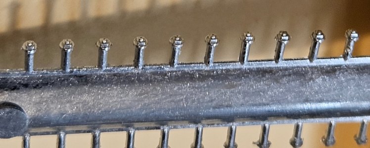

I would also like to update that the first type of special nail (round head with a square nut at the end) came from the company Kedda. I liked the quality.20251112_190604.jpg20251112_190519.jpg
Now I am waiting for the second type that was ordered from a site in France with the help of a member of the forum.
In the meantime, I hope you enjoy the pictures, I wish us all a pleasant and enjoyable weekend

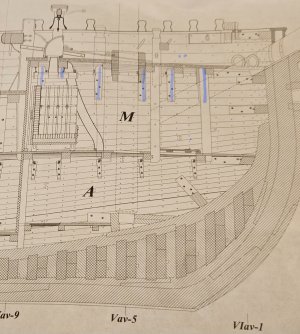

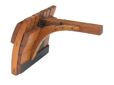

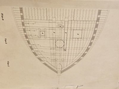

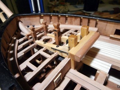

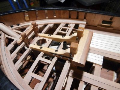

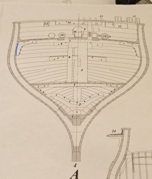

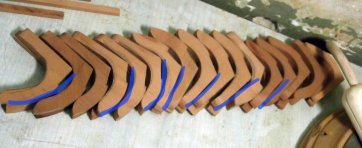

My Dear friends

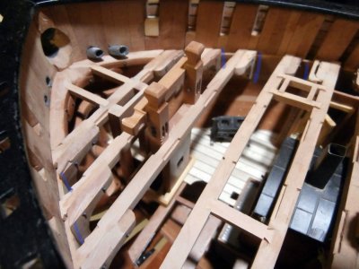

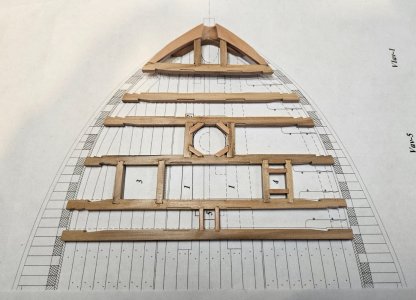

I'm ask for your help in guiding me on a part that I cannot understand the dimensions and the correct way to prepare.
I am trying to understand how to make the brackets of the beams. "Beam arms.
I am attaching pictures from the impressive model of our friend Richie, that made the supporting the upper deck in the bow.
In the ancre drawings, this part of the side/side has a different size.
I would appreciate it if you could teach/guide me how to build it correctly.
I measured and there is a 2.5 mm gap between the two pictures of the part on the wall of frame number 4-5.
Did I need to do it from a long block of wood and cut/mill it with a milling cutter like on the sides of a gun carriage. Any information would help me a lot.
Many thanks Shota

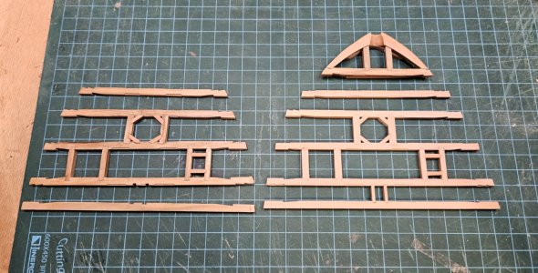

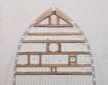

In the last few weeks I haven't been able to find enough time to work on the ship.
The main thing I managed to do is re-create the crossbeams of the forward upper deck in the bow.
I did this because I wasn't 100% satisfied with the shade of the local pear.
So this time I created it from European pear, and the results are noticeable accordingly.
Wishing everyone a pleasant and enjoyable weekend20251206_171504.jpg20251206_171405.jpg
