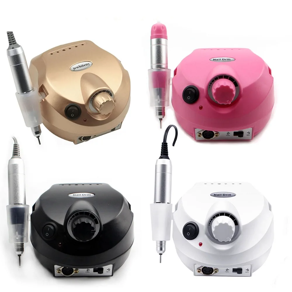

I saw this Chinese "Engraving tool" down some internet rabbit hole, and figured it was inexpensive enough to go ahead and order one.
It is actually made for doing fingernails. I have some projects where I am engraving plexiglas and corian to make forming dies for soft sheet metal. For the price it is pretty amazing. The handpiece is the best part- it feels solid, handles nicely and is more like drawing with a pencil than other cheap rotary tools. Best of all, it is variable speed and reversible which is important when you are doing rotary engraving. The foot switch is plastic, but will be easy to replace when it breaks. The transformer/control box is WAY too lightweight. It is easy to pull it around with the very stiff coiled cord, but a drafting weight keeps it in place. It' so light I really worry how long the transformer will last, stepping down 110v AND 220v to 12v DC. The European plug just plugs into a US standard adapter. It takes a limited shank size- seems like between 2.25mm and 3mm. I had a few carbide burrs that fit, and 3mm seems to be standard for inexpensive diamond and stone burrs- I have a bunch from the US Harbor Freight 9.95 USD rotary tools. After playing with it, works great! With the Optivisor on I can see doing ships carvings with it. I'm not sure how hard 3mm shank burrs will be to find. I'll report back when and if it fails.
