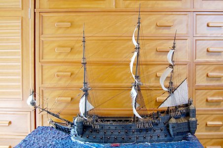

The main sail was finished by applying clear lacquer spray to set the decals, spraying clear lacquer spray again to protect the decals, and finally applying clear flat lacquer spray.
I observed it for about a month, and the decals showed no cracks or peeling.
Even when rolled up, the decals didn't peel off, so it seems fine.
Therefore, to make the lower edges of the main sail appear as if they're catching the wind, I added a curl to them.
・Focus on Reef points:
The Reef points on the main sail are located on the illustration of the double-headed eagle.
Black areas use black thread, red areas use red thread, and whitish areas use white thread.
Reef points are not applied to the eagle's face.
It's not ideal for Reef points to stand out prominently on the face area.
To make the lower edge of the foresail appear as if both ends are catching the wind, I rolled it to set the crease.

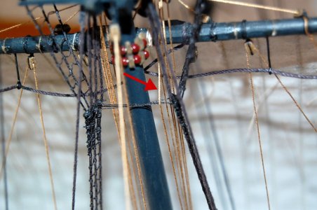

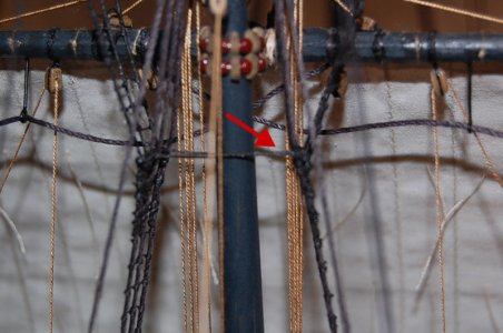

I installed the main sail.
The image below is an enlarged view of the white arrow.
View attachment 549022 View attachment 549023
The enlarged image above is intended to recreate Jeers.
The image below shows the enlarged left and right Jeers sections.
Finally, I've become a Jeers, so I'm feeling pretty pleased with myself.ROTF
That's all for today. :D

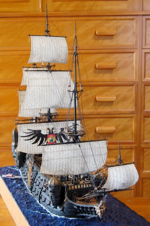

I've installed the main top sale, main top gallant sale, and foresail.
I haven't done the running rigging for each yet.
Side view image.
Running rigging hasn't been installed yet, but each sail looks like it's catching the wind.

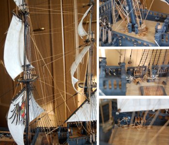

I finally managed to rig the running rigging for the yards and sails attached to the Mizzen Mast.
I skipped a few steps here and there, but I somehow tied it all to the belay pin.
The space between the mainmast and mizzenmast is now completely filled with ropes, leaving no room to even fit a hand in.
The ropes tied to the aft belay pin are mostly as I had planned.
Since the foresail is already up, next I'll attach the topsail and foretopgallant sail too.
The fore topsail and fore topgallant sail have been set.
The sails look like they're catching the wind.
Setting the bowlines should improve things a bit more.

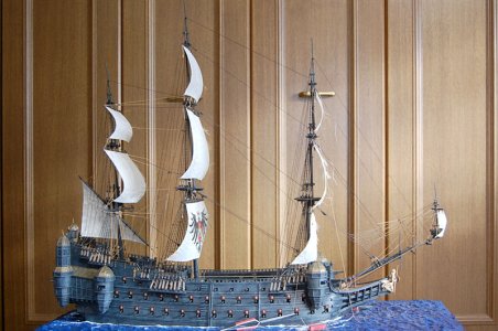

All the sails we planned to put up are now in place.
The running rigging isn't done yet, and the anchor isn't attached either, but once all the sails are up, you just want to take commemorative photos, right?
I tried taking some from my favorite angle.
No explanations included.
The running rigging isn't finished yet, but please enjoy the view, thinking this is how it will look once it's complete.
All the sails up looks so cool.:D

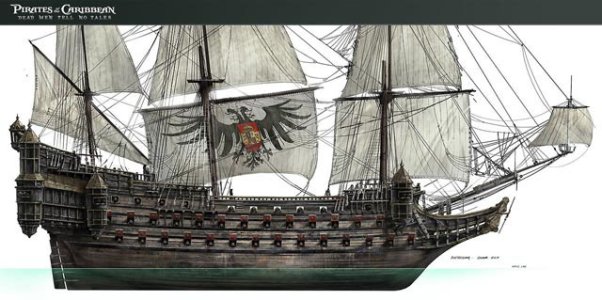

I think it looks pretty similar to the Silent Mary concept art, but maybe that's just me being self-satisfied?! Hehe...ROTF
