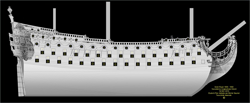

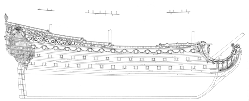

I noticed the monarque doesn't has the same pattern around the fleur de lys as the Berain soleil royal drawings (I thought they were Vary, I see they seem from Berein now) so for a intial Sr, they're not an obligation.
Both Saulnier, and Neko choosed to place the "molures/Frize dorée" (page 29 of royal louis description) on the 3rd battery (wich might've been Tanneron choice given the ports look verry different there than the one below).
source: https://5500.forumactif.org/t52p520-soleil-royal-1669-echelle-1-72
My initial SR "molure" will roughly look like what they did.
By the “golden frieze mouldings” do you mean the draping bell-flower moulding that runs between and over the round main-deck ports?
Or, are you referring to the Crossed-L monogram cartouches that exist between the quarter deck ports?
It is fascinating to note, with this over/under comparison, how remarkably different Marc and Michel’s interpretation of this ship is, despite both building within the same dimensional parameters.
I'm adding them on my 1669 SR beakhead, wich ship is that? On the port door ornament, the royal louis had multiple kind intialy, would it be the case for SR too? I guess we don't know their order on the intial soleil royal . By golden frieze muldings, I mean the one on the main deck, not the crossed-L monogram catrouches.
