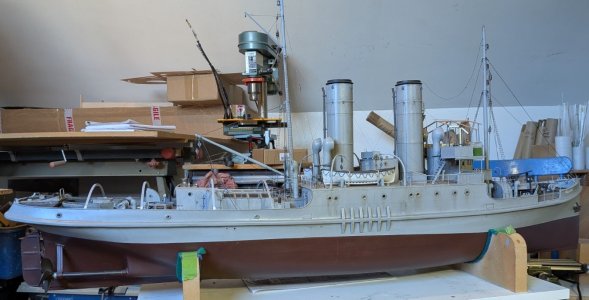

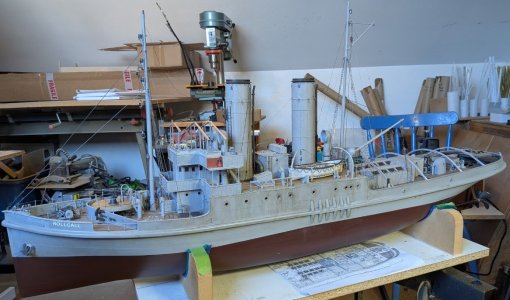

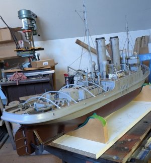

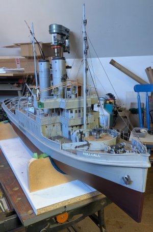

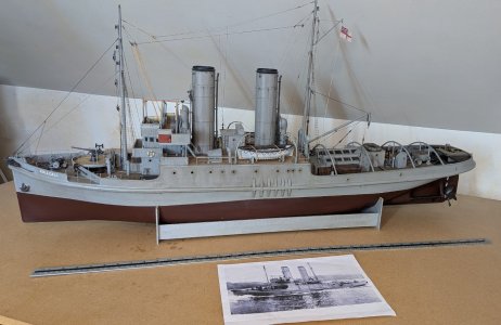

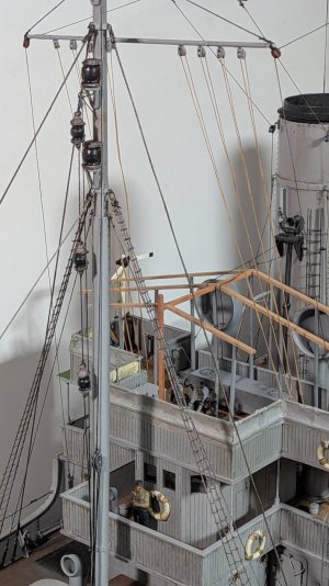

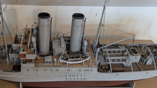

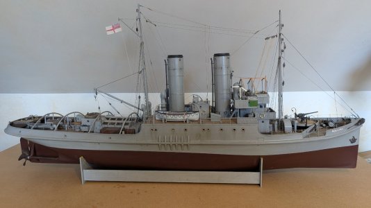

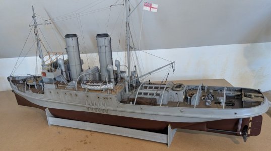

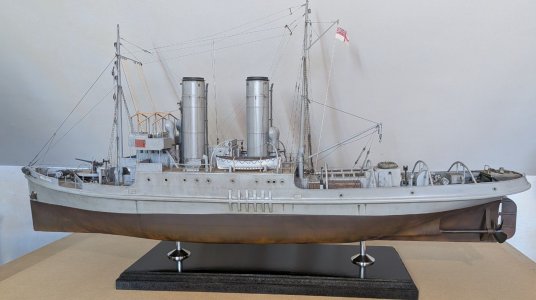

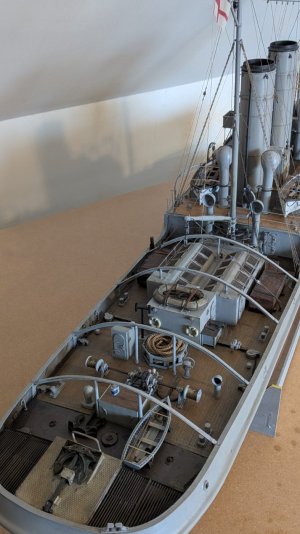

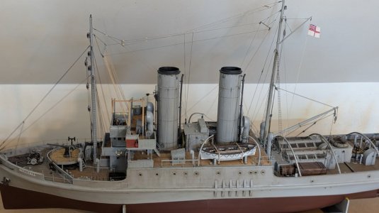

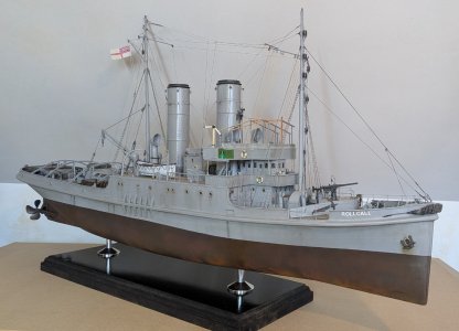

The Ocean going rescue tug, HMT Rollcall W81 1920, Built using Caldercraft's Resolve grp hull and plans (much modified).

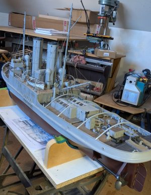

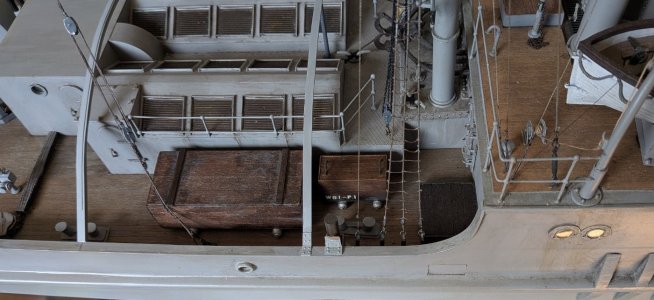

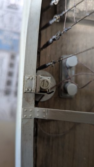

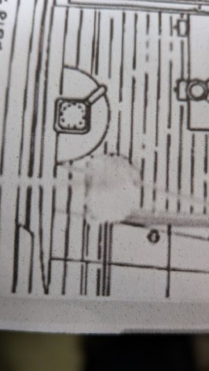

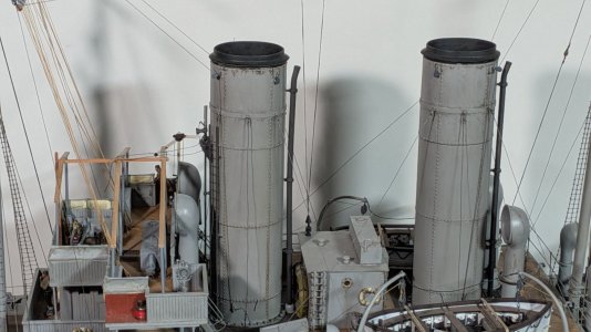

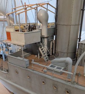

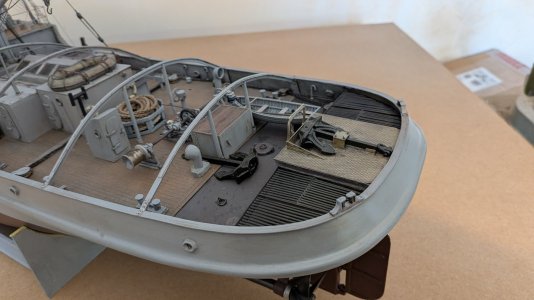

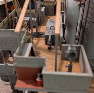

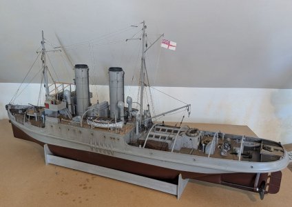

I have been uneasy about my interpatation of the BST plan of Rollcall showing, what I thought was, a davit support on the wash deck, and the more I thought about it the more I felt I had got it wrong. I now feel, (certian), it is a base for a samson post, both port and starboard which makes far more sense as placed there it would protect the rigging from the tow rope ripping throughit if the tug is 'girted' ie heals and turns so that the tow slides towards the beam I think. I really need to read more about tug handling.
No matter it was lucky that I attched these bits using pva so they are already pulled off and it is time to go again.
