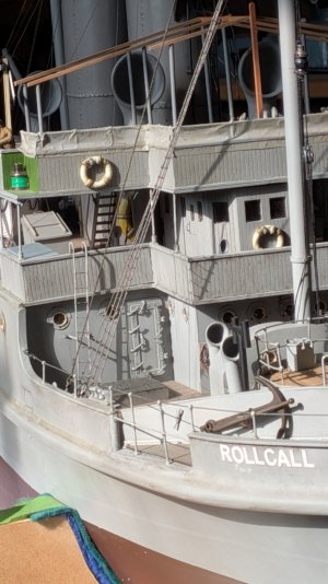

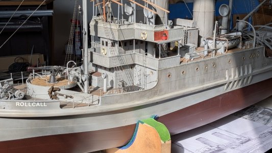

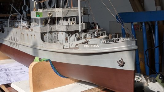

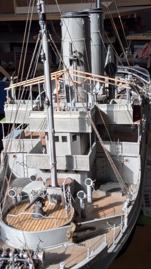

Good evening,
Juat about finished all the deck fittings, the last being four crates on wheels that are to represent two portable salvage pumps and their gear. They don't look like much and I might dump them. I had the bright idea of stenciling on some i.d., but that does not look right so I will give it the bye ball. The towing bows were very difficult to get exactly right but look acceptable. Still a bit to do with the rigging then one final layer of detail and painting after that a decision on how to finish the hull. When I started this build I recond to have it done and dusted by August so still well on target.
Some photos
PXL_20260714_092742184.jpgPXL_20260714_163626030.MP.jpgPXL_20260714_163717223.MP.jpgPXL_20260714_163749639.MP.jpgPXL_20260714_163825425.jpgPXL_20260714_163847312.MP.jpgPXL_20260714_163923421.MP.jpgPXL_20260714_163947433.MP.jpgPXL_20260714_163957956.MP.jpg
