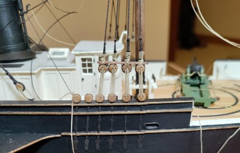

What are those grooved called where the lanyards rest before passing through the eyes? Also, are the grooves on both sides?
Hi Chuck, I loved the overall view you posted recently. She's pretty!
I'm not aware of the grooves having a particular name. They simply allow the lanyard to run smoothly through the deadeye and lay properly across the face. Yes, both sides.

Paul! Thank you! Next question: what is the bit you used to make the grooves? Source? Please don't say that you've repurposed your old work tools ROTF
I'm particularly thankful for the picture. I like seeing how the sheer pole is attached. Very helpful. As usual!

Cheap diamond drill bits for a rotary tool. Amazon. EBay. AliExpress.

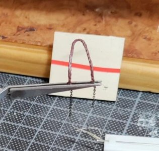

I finally finished the ratlines! AND I was able to case the lower fore yard chain sling in a simulation of leather. At least to my satisfaction:p

I am particularly please with the leather covering on the fore lower yard chain sling. I used some acrylic matte medium that was thickening-up to coat the chain. I let this dry a bit and added a second coat. I waited a little and rolled the chain in a single ply of Kleenex just enough to go around twice. I let it dry just a bit and placed it on the foremast in position over night. In the morning I took it off. The took a little prying with a toothpick because of the adhesive quality of the acrylic matte medium. But, I got it off without ruining the paint on the mast or the wrapping on the chain. I then painted it with what I have in my paint locker - Model Shipways Hull Red with some slight touches of Deckhouse Brown on the not quite dry Hull Red. As you can see, it had retained its shape and it is not so thick as to completely mask the fact that it is covering chain. This I may be totally wrong about, but, to me, the leather would not be so thick that the chain would leave no evidence of its existence. To the contrary, the leather was, in my imagination, thin and pliable enough to prevent the chain from chaffing the mast and to allow the chain to follow the contours of what it was wrapped around - so the chain would be evident in its leather sleeve. BTW - the color of the leather looks a lot less like raw liver in person:)

Chuck, Nice work as usual!
I believe that the reason for leaving he ratlines off the main topmast is that there are no square sails here; only the gaff topsail. I also believe that this sail could be set without climbing the topmast. I don’t have time at the moment but I’ll do some checking later today.
Roger
Another thing that is strange in the instructions is the direction to leave ratlines off the main topmast. Why?
Roger is right about the top sails. It’s also on the schooners like the Bluenose. On that ship were only a few ratlines till the height where the lowered topsails with the mast hoops where collected. And on the main mast a few more then on the fore mast. To then temporarily tie them together with a line. But on your fore mast there is a square sail.
And I think that the gaff sails on your Harriet Lane were lowered to the fore mast.
