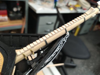

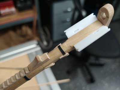

Finally I have been able to make 3D printed ships boats.
Lots of prototypes which I used to develop paint and finishing techniques.
Whale boats.
The boats are a combination of wood and printed parts, I'm happy with the way they look but there's lots of errors if you look carefully. I have lots of ideas for the next time I need to make ships boats. There's a number of small details to add which I'll do later.
It's taken a while to learn how to make these boats with CAD. Once the boats where printed the process is much quicker and more accurate than using the manufacturers method.
Tony
