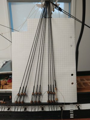

I must admit I have been putting off making the hammock nets until absolutely necessary. This is how I did mine.

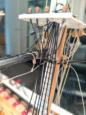

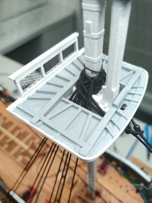

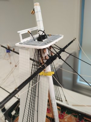

First the easy part fix the PE posts in place care has to be taken as they bend very easily.
It's hard to see in the photo, first I put the netting over the posts then threaded a piece of 0.3mm wire through the holes.
I used some thread to attach the netting to the wire. When finished I trimmed the excess netting.
Job finished, quite time consuming and very delicate work.

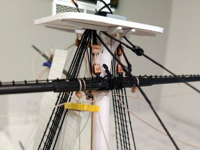

As I was really worried about damaging the nets I made some removable plastic blocks to fit between the nets. These make it a lot harder to damage the netting.
