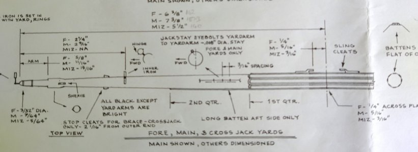

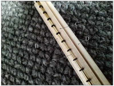

Thank you for photos, the rings look perfectly round. Being new to this era and trying to learn, can you explain what the various parts are? It is no doubt just me, but I cannot figure out which part is the actual yard. Many thanks for your help.

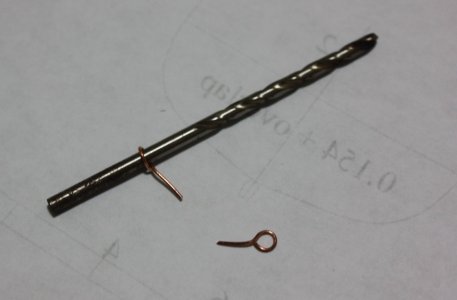

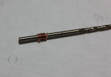

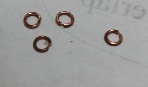

I really like the tools above but maybe because I am too cheap to buy them I go the simple route. To make a lot of rings and eyebolts that are all the same exact size and with dozens of different diameters available, drill bits work great. My preference is copper as it is clean, easy to work, and blackens much more easily than brass. I do use brass wire/rod on occasion, but it can be worked the same way.
Find the ID of the eye bolt needed and wrap the wire around the appropriate size drill bit.
Snip the excess and remove the eye bolt
Same principle for making rings. Wrap the wire around the appropriate size drill bit numerous times, then remove the spring and snip the rings.
The rings can be soldered if they will be under stress on the model. Both eyebolts and rings can be cleaned up with some acetone them brushed with diluted liver of sulfur before or after being installed. I find it easier to install the parts then blacken them once fixed in place as the diluted LoS will not stain the wood.
Hi Allan
Thanks for the reply the yards are difficult to photograph and show a lot of detail.
The drawing shows the parts better than my photos.
A is the jackstay
B,C & D are the batterns fitted around the yard.
Hope this helps.
Tony

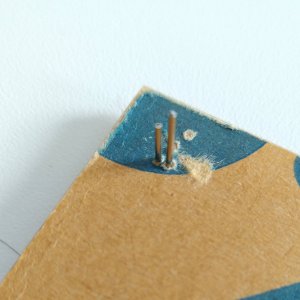

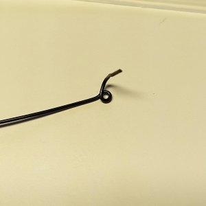

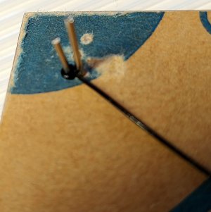

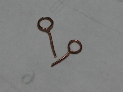

what did you use to make the eye bolts and did make a jig for bending them

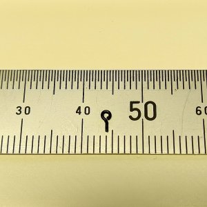

There's lots of tools and ways to make the eyebolts my problem was the small size. I'm using 0.5mm wire making an eyebolt with a 0.7mm hole no tool I had could make one that size.
I made a simple jig using Perspex and two 0.7 pins.
Bend the wire around the first pin and use the second pin to bend the wire at 45 degrees.
Trim the excess wire.
Complete.
Tony

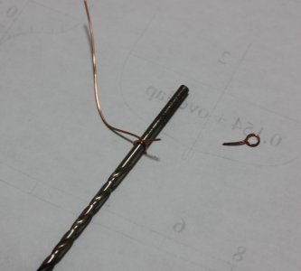

Here's how I make small eyebolts from jewelry wire. It's a short YouTube video that I haven't had the time to add a narration. Basically formed by twisting the wire around an appropriately sized drill bit. The tool I am using to hold the wire is a hemostat clamp.

I like this method and used it for the eyebolts on the gun carriages. The disadvantage of this method is the holes required are nearly twice the size and there's a twist at the bottom of the eye.
Same wire and hole ID, the holes required in the yards need to be a lot bigger.

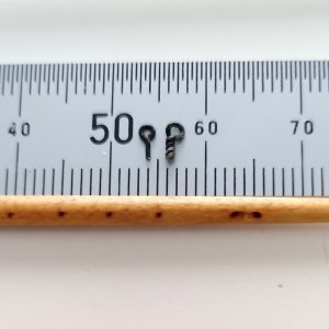

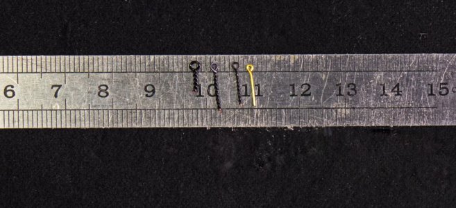

Here are some examples of the ones that I make. the wire sizes are (left to right) 24, 26, and 28 gauge. The brass is the size supplied with the Model Expo Conny. There are not nearly enough to do the yards included with the kiter
The size of the eye can be controlled by selection of the drill diameter. 28 gauge (0.32mm) wire is a nice size for the yards and the twisted part in not very large. I used these on the Conny cross section that I made. You can make a hundred of then in bit over an hour. There is some potential advantage of the glued twisted stem holding in wood better than straight wire.

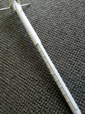

Hello Tony. I'm starting to prepare the masts. Your chafing fish of the masts look perfect. Can I ask how you made them?
Sorry for the late reply. I used 3/32 * 3/64 strips chamfered on the edges so they fit together without too much of a gap. I also fitted the caps first which made shaping the ends of the chafing fish much easier.
Tony
