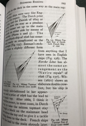

So, that's what the plans say. I had a problem with this as this meant that there was no adjustment for tension to be applied at either end of this rigging. The upper stay pendants at the mast head cannot be tightened, nor can the lower crowsfeet attachment at the shrouds, so I went looking for an alternative. I found it on Page 123 (Fig 135 and Fig 137) of R.C. Anderson. In this description of the Norske Love rig of 1926, he adds a second block below the mizzen stay pendants on both the port and starboard sides. You will also find this arrangement on Clayton's rigging I think.
Having the second block, meant that a line could then be transferred to deck to tension these stays and the crowsfeet as part of the standing rigging. Personally I think this may have been an error in the museum's Rigging Plans.
