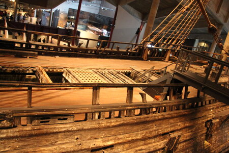

I remember reading in a build log that the upper railings could be troublesome to fit if too much rigging was in the way. The upper railings sit above the molded white railings already in place and which serve to hold the belaying pins and running rigging points. Early ideas of belaying pin rails fitted at strategic points around the ship were discounted by Fred Hocker, and these railings were the preferred locations. There are some belaying pin racks on the ship, for example there are four on the beakhead, but on the main deck, the railing, the knightsheads (with crossbars) and the kevels appear to have been the main belaying points. So, above the railing, is a second, much thinner and less robust railing which on most models I have seen are finished in natural wood rather than painted, although some are (see the Janssen German model example in post #206 above.
The Billing kit supplies these railings as laser-cut plywood in sections with four per side. The different sections have vertical support posts which go up and down depending on the rake of the deck and the steps in the belay railing onto which it is to be supported. The method of securing the upper railings is not described in the BB instructions but assumedly, it is by gluing the posts to the belay railing and providing temporary support while the glue dries. Obviously this would not be especially strong, especially if these railings were to be fixed before rigging and then subject to bumping or movement while rigging was getting done.
So, what I have done is try to increase the strength of the support for these upper railings is to add a series of brass wire pins which are attached into the upper railing support posts and then drilling into the belay railing beneath. With gluing and these pins, the railing actually feels quite firm. Also, because of this support, the railings can be permanently added after standing rigging. They may be able to be added after running rigging, but I will wait and see as I am not up to this stage yet.
Below I show one of the upper rail sections with the brass wire pins inserted into some of the support posts. I chose the posts depending on the shape of the railing and the belaying railing as these of course are not straight, but follow the curvature of the ship decking.
Also, it appears that the upper railings were positioned centrally over the lower rail (see picture below). The holes I have drilled
in the lower railing to support these upper railings reflects this. The railings are quite fragile and placing the brass wire pins was a delicate job as you had to be accurate in the drilling and not piece the sides of the support posts. The depth of the pin to be exposed too had to be measured and cut off at a depth which did not go right through the lower railing, as this would then be seen from the outside of the ship.
This approach of having pre-fitted the upper railings and then taking them off once fitted and measured should help for the rigging phase. I think I should be able to place and position these without too much trouble at a later time without the concern of knocking or bumping the fragile railings. It would not be a nice job to have to fix any broken timbers with the rigging ropes in place. Better to be safe at this stage while I still have relatively easy access to the lower railings.

Кроме того, похоже, что верхние перила были расположены по центру над нижними перилами (см. Рисунок ниже). Отверстия, я просверлил
в нижних перилах для поддержки этих верхних перил, отражают это. Перила довольно хрупкие, и установка шпилек из латунной проволоки была деликатной, так как вы должны быть аккуратными при сверлении, а не кусать стороны опорных стоек. Необходимо было измерить глубину открываемого штифта и отрезать его на такой глубине, которая не проходила бы прямо через нижние перила, так как это было бы видно снаружи корабля.
PeterG, судя по фото, стойки верхних перил проходили рядом с нижними, а не заканчивались на перилах. Посмотрите фото, которое вы прикрепили. Я обозначил это стрелками. Может я ошибаюсь и ракурс фото нехороший, но я так посмотрела.Railings.jpg

If I could make a suggestion, it seems the actual railing is more ornate than a flat piece of plywood...therefore I would suggest adding a radius to the existing piece on the top edges, then capping it with another thin strip of wood. That would simulate what is pictured above, and make it more ornate.
For those without a Russian translator installed, Alexander has posted the following in Post #208:
"PeterG, judging by the photo, the posts of the upper railings passed next to the lower ones, and did not end on the railing. Look at the photo you attached. I marked it with arrows. Maybe I'm wrong and the angle of the photo is not good, but I looked at it that way."
To Alexander:
I believe you are correct and I had not noticed this before. I have uploaded a better photo of the ship starboard side below (taken in the museum in 2017) and this clearly shows what you are saying, with the upper railing supports going through the lower railing and secured into the ships side planking. Well spotted!! Unfortunately, with my current build and embarking on the rigging, I don't think I am going to be able to change this now, but a good 'heads' up' for other builders!!
In Russian:
Я считаю, что вы правы, и раньше я этого не замечал. Я загрузил лучшую фотографию правого борта корабля ниже, и это ясно показывает, о чем вы говорите, с верхними опорами перил, проходящими через нижние перила и прикрепленными к обшивке борта корабля. Хорошо подмечено!! К сожалению, с моей текущей сборкой и принятием такелажа, я не думаю, что смогу что-то изменить сейчас, но это хороший сигнал для других строителей !!
Many thanks Alexander,
PeterG
To Paul (docattner), the use of plywood I deplore in these kits. I don't have a major issue where it is a panel or surface that has enclosed edges, but where the layered, sandwich edge shows, it is a real negative. You will note that Dean has added the suggestion of laminating or covering the upper railing plywood with a 'real' layer of shaped timber. I will have to look that. Thanks for this suggestion Dean, it is a good idea. I have used shaped wood for the strakes below my lower railings and it works really well. I made this simply by taking some stripwood and making a shallow cut with a 'rounded' blade on each side, then sanding and it worked well. I possible could do something similar for a top layer added to the upper railing as you suggest. Trial and error is our friend!! Also see my next post about some timbers I have been using recently.
To also answer your additional question Paul, I had intended to leave the upper railing the darker, stained colour. My lower railing is currently white to contrast the red and yellows of the clinker cladding below and I think the natural timber look is more appealing, but in light of what you say with the plywood, painting to match, a similar white, would largely hide the plywood laminations. I guess this is what Billing's were relying on in using the plywood in the first place. Equally, these upper railings are so thin at this scale, that if they had used 'real' timber, it would be even more fragile and prone to breakage both in transit and in mounting. Also, of course, the use of plywood makes it easy for the manufacturer to make by use of laser-cutting of the plywood.
Thanks,
PeterG

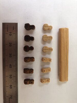

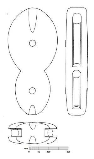

In my Post #206, I mentioned that for the mast tackles, I was going to use violin blocks. This is an interesting type of block used on the Vasa. In 'The Rigging and Gun Tackle Blocks of the Swedish Royal Warship Vasa" thesis by Howe (2011) the author describes the blocks below:
"The second largest group of double blocks have elongated, figure-of-eight shaped shells containing two sheaves of different sizes arranged end-to-end in the same plane (see below). These are easily recognizable as fiddle blocks. For four of the five examples, the two sheaves are the same thickness, indicating that these carried the same size cordage and were used in rigging what are known as long tackles—a name reflecting the elongated blocks that streamline the profile of the tackle. "
The shape of these blocks is as:
Note that my terminology (a violin block), is a newer version of a 'fiddle' block, due to the shape and the likeness to the musical stringed instrument (violin, fiddle etc). It appears from a number of Vasa models that the most prominent usage of these blocks was the tackle lines used in supporting the back (aft) tension applied to the masts. Refer to post #206 for an example of this.
So, if these blocks were to be used on the ship, and the Billing kit manufacturers saw fit not to include them, I thought I would have a go at making my own. The first task is to choose some suitable wood and then the mechanics of shaping the wood in my meagre ship shop. I do not have any fancy milling machines or routers etc - only a small power saw, files and sandpaper. My thinking was, as I needed about 16 of them, I would attempt to make the 'shape' of the scaled size and then use the saw to simply cut them the correct thickness, drill, file, sand and finish.
What timber to use? In Australia, where I live, I don't have access (other than by internet purchase and mail) to local hobby shops or boutique timber yards. I could have opted to buy some timber from overseas and have it sent over (maybe pear, cherry, or other exotic timber etc), but following a recent working trip to Tasmania (pre-pandemic in March 2020), I visited Macquarie Harbour and Strahan on the West Coast. For those of you who know this place, it is the ocean opening to the famous Franklin and Gordon rivers, a scene of demonstration and unrest in the 1980's around the construction of hydro-electric dam sites. This remote and isolated area however is especially known for the native forests to have a reasonably prolific abundance of Huon Pine. Below I provide some background to this amazing timber:
"Huon Pine only grows in the wet, temperate rainforests of South West Tasmania – on the whole planet! ‘Lagarostrobus franklinii’ (its proper name) is not actually a pine and is the only member of its family, so a pretty unique tree which grows extremely slowly, averaging just 1 millimetre in girth per year. They can grow to be 2,500 years old which means some of them started life BC! Add to this the fact that they do not start to reproduce until 600 to 800 years of age and you have a very special tree whose timber also has remarkable properties. The timber has a very high oil content, methyl eugenol to be precise, which renders it impervious to insects, waterproof, and imbues it with its characteristic sappy perfume. The high oil content also means the timber can be bent, shaped, worked and sculpted without splitting and finishes to a superb, fine lustre. Pale straw coloured when first cut, it ages to a rich honey gold. Woodworkers love it!"
"The early settlers discovered the remarkable properties of Huon Pine and saw its potential for boat building, resistant as it was to those perennial problems of the boat builder, marine borer and screw worm. It turned out to be the best boat building timber in the world and was exploited heavily in the early days, driving a huge industry based on this ‘green gold’.
Interestingly, concern for the future of these venerable giants started early in the last century – even back then it was apparent that there would be no next generation of trees to be had, their slow growth precluding the possibility of plantation farms.
The felling of green Huon Pines stopped completely in the 1970’s after a consensus that it was neither sustainable nor prudent to cut down trees that were 1000 years old. However, a careful stockpiling operation was begun when trees were felled and collected prior to the flooding of several valleys to create dams for hydro electric schemes. For decades these logs were tied into huge rafts and left to float unperturbed on the water until needed. The stockpile created when Lake Gordon was flooded in 1972 still supplies the majority of logs released for use each year."
During my trip, at an antique sawmill, I purchased a few isolated offcuts of this remarkable timber. It is a light, yellowish, extremely dense softwood which is strong but ideally suited to scale carving and working. I decided to give it a go for the fiddle blocks, so I cut a strip of the correct size for the scaled blocks and then commenced shaping it. To say it is a pleasure to work with is a massive understatement. The sawdust is like talcum powder and the smell is divine!! I shaped a small length of the stripwood into the shape required and started cutting off the thickness of the blocks, before drilling and filing the side rope indentations.
The colour of the timber is a light yellow/brown but I needed it to be a darker more brown colour, so I dipped a sample into some stains and chose one that I thought was satisfactory. Below is the final product. These still need a bit of sanding and smoothing, but the result is quite acceptable.
I then placed the blocks into the tackle lines and rigged the lanyards. There are three sets of tackle lines in this part of the main mast rigging and it looks OK. Only one thing I could have additionally done and that was to slightly engrave a groove around the rigging holes to represent the sheaves which would have been in the blocks.
I am really pleased I was able to use some of this amazing timber on my ship as its history and where it came from is special. Hopefully I may be able to shape some more items for use from the Huon Pine.
