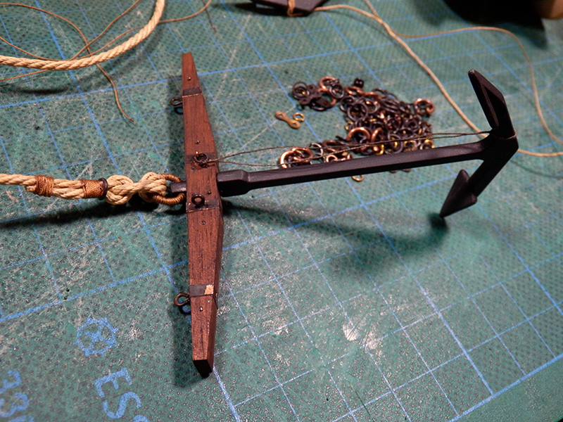

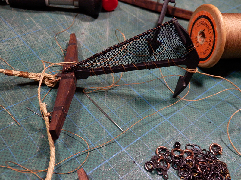

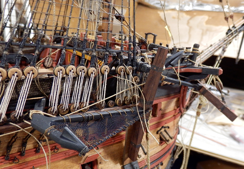

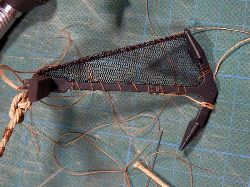

Until I took care of the yards and sails, I had to do the four main anchors ...
One of them is equipped with a net: it allowed when it was along the hull to have one or two sailors to do depth surveys without being hindered by the hull.

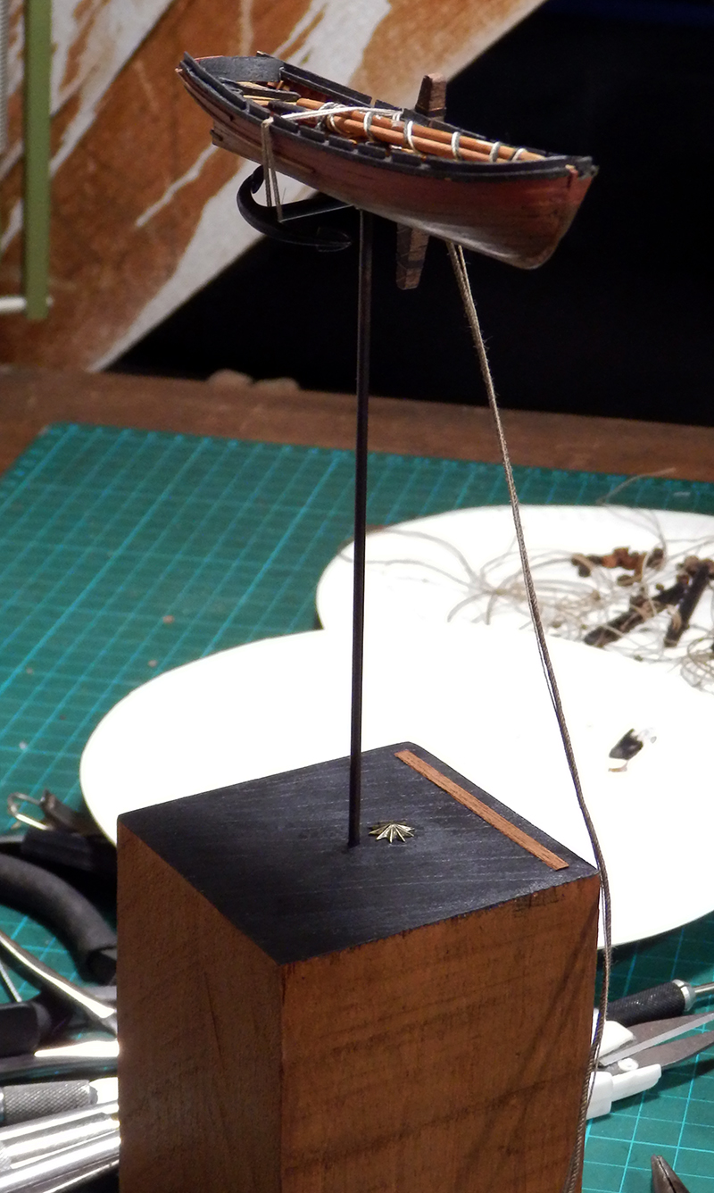

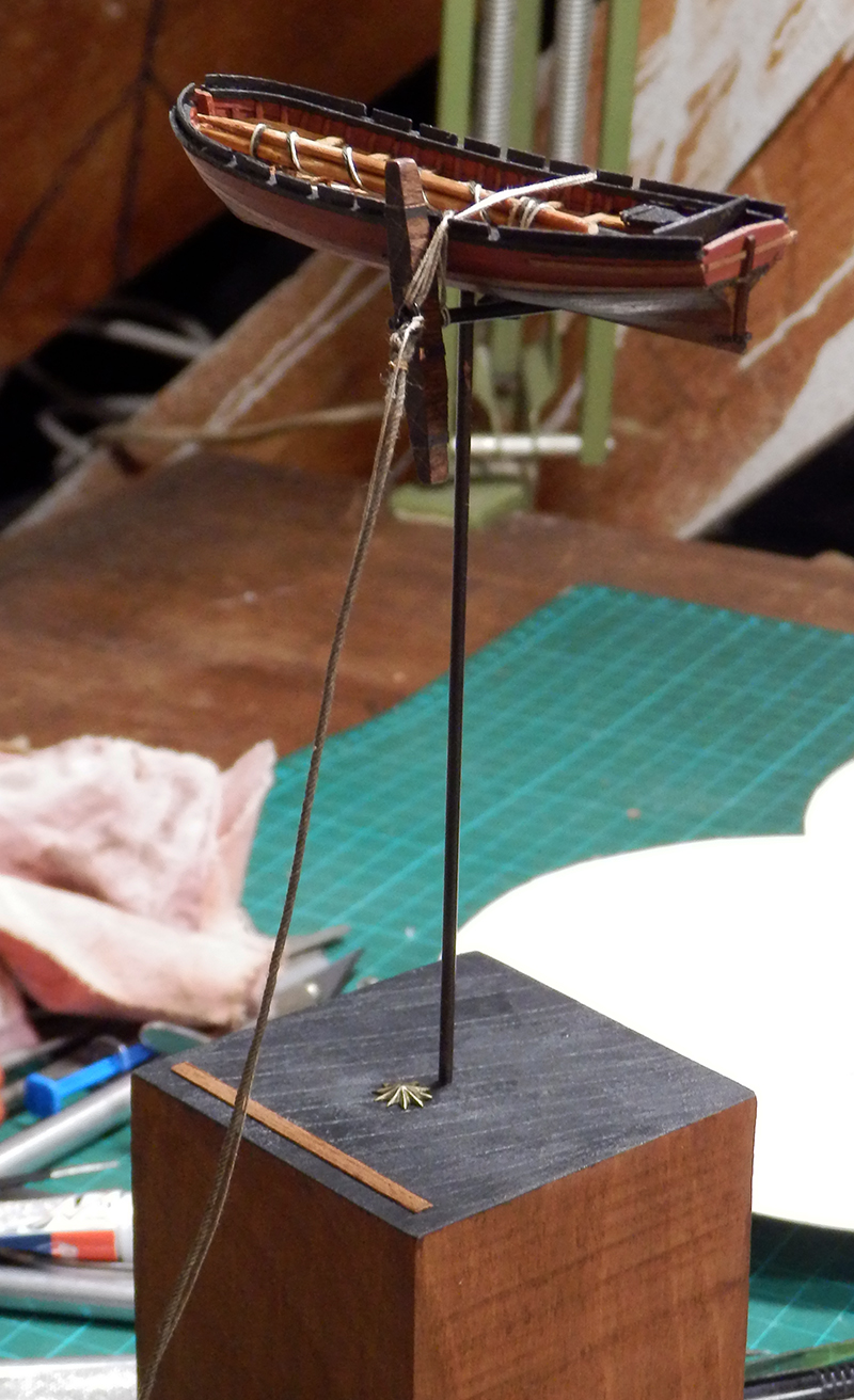

And then, while I was there, a 2nd boat is mounted on an individual support. But this one has an anchor below. This is how they were moved farther away from the ship to anchor in a safer way.
The boat will be attached to the boat by the cable of the anchor and a mooring end with a hook.

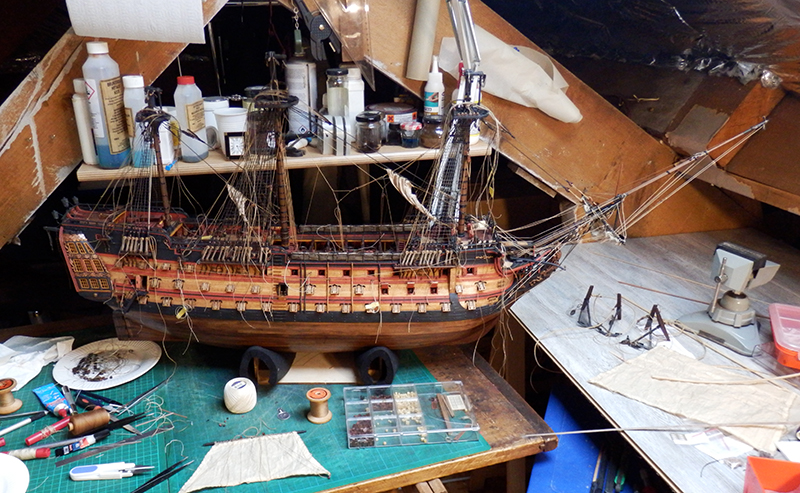

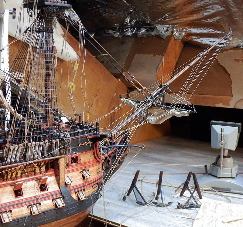

Some views of the job in progress ... It is really a considerable time this type of rigging !!
I still have many, many hours to spend on it, but it goes at its own pace.
As a reminder, all the sails will be carved, which adds time to spend on each one so that it is presentable and relatively realistic (taking into account that I use the sails of the kit AL which are of a quality say more than medium ...). All the lines of each sail are to rethink from the plans to be able to moor them properly once folded. Speechless

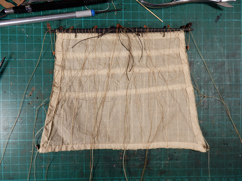

In fact, I did not manage to make a proper folded sail with the tissue paper. So for now, I use cloth sails that were to be the Studding sails and I cut them to become the sails of forestay.
For the other sails, I will take those in fabric of the kit. ;)
Before I started assembling the sails on the yards, it was necessary to cut them correctly: it's done!
It remains to fix them, to prepare the ropes for each one ... and to put them on hold until the top of the rigging is in place.

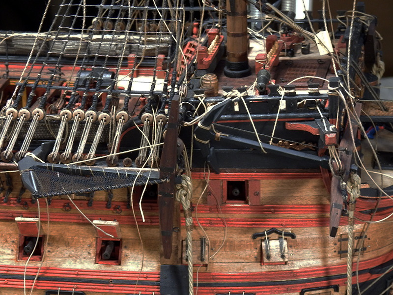

But first, there were still and always details to finish ...
Set up the spritsail topsail,
And all the ropes that pass through the bowsprit racks,
Tarred canvas protection of rudder head,
rail with nets for the front platform:
And finally, for fun, a 18th century buoy (image found in my archives to reproduce it):

I continue the work on sails and yards. It's a big job at the base, work on the octagonal part of the yards, aggravated by my choice to show these sails furrowed ... It is necessary to work the folds, to think the bolting otherwise for that seems realistic. I am obliged to put invisible threads to create gathers, etc ...

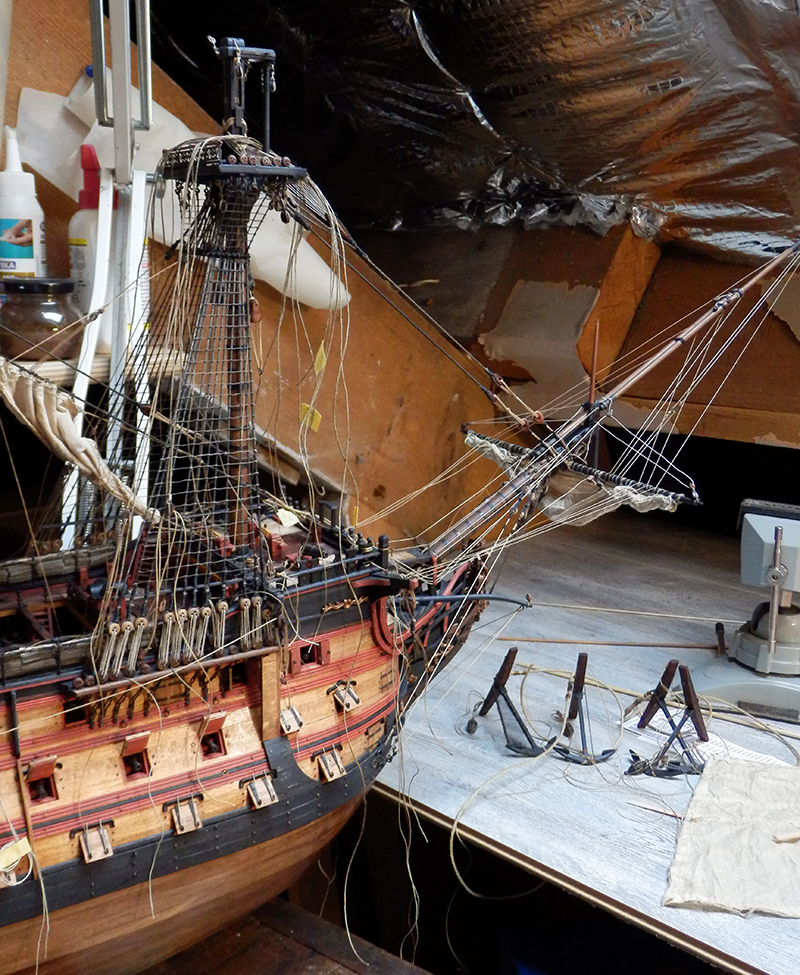

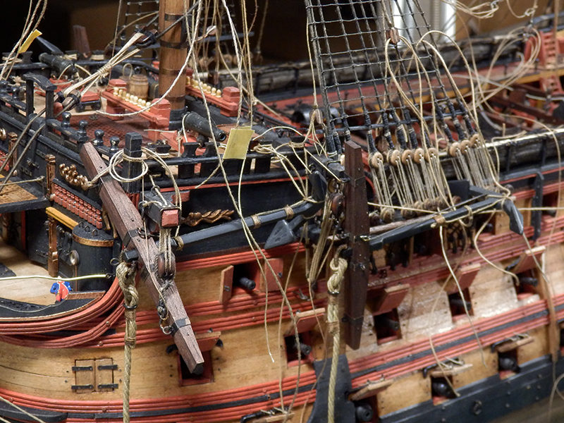

A few close-ups of the bowsprit, the rigging of the yards, the flag pole at the stern.
And then, finally, all yards rigged with high masts: a bunch of wires everywhere !!
Finally, again the stern ports finished with their string shutters.
