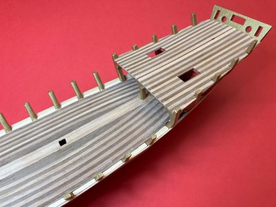

All finished. You can see a few lozenges on the stbd bow that I didn’t round off before fitting. They were before my road to Damascus moment. I’ve done what I could with a tiny chisel but they will stand to remind me of my breakthrough. Or breakdown if you like. Ha!
I think it’s looking beautiful. X
And that’s the main thing, innit?
Good afternoon Smithy. Looks very cool. The deck edges look way better with the walnut edging. Cheers Grant.

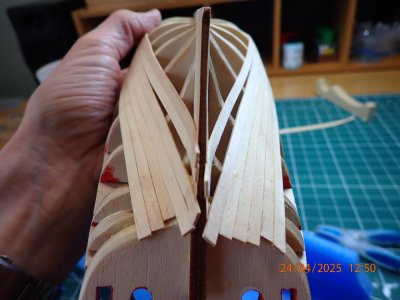

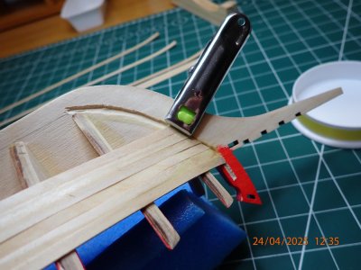

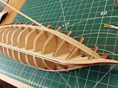

Today I am a big planker, something I've been called before. (I think that's what they said, anyway.)
I wanted to see how much faster i could plank using my hot Titebond method, which eliminates clamping and glue drying time. I began with four planks already attached from yesterday, and worked downwards alternating sides. I didn't rush at all because this wasn't a bid to break records but an attempt to discover my relaxed planking frequency. I didn't stop the clock for, making coffee etc because that's pretty much a constant time loss, whatever I'm doing.
There's a plank welded into the stem and the first three bulkheads, no clamps, no superglue, the remainder just hanging there waiting to be secured. The glue on the plank and the bulkheads is already dry so there's no rush, no mess.

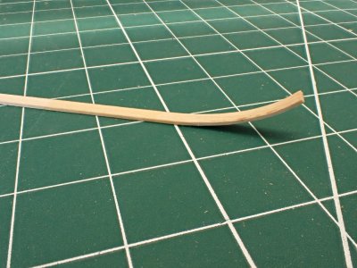

That's all the plank bending I'm doing. That's in order to line the wood up for a smooth entry into the rabbet.
Two hours and five minutes. Six full length planks attached and already firm enough for a rub down with sandpaper. Compared to the conventional methods that I used to use, that's about two days faster.

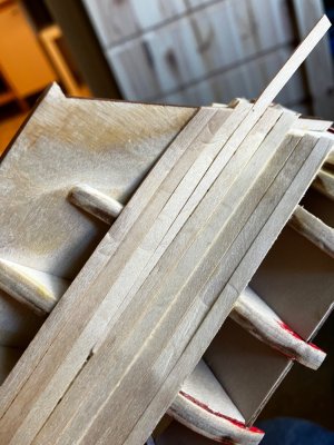

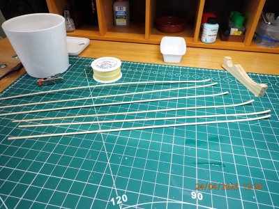

The after dinner session is to be a bit more organised. Not quite production line but working in batches. Six planks this morning so I'll try six again. Not rushing but being efficient.

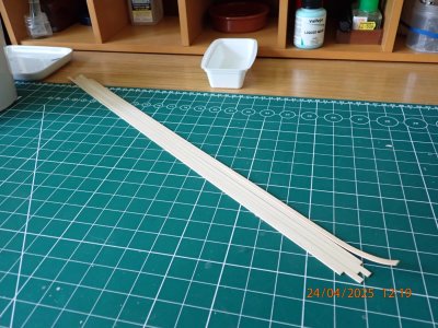

Start 12:19 one plank already bent from last session.
Remaining 5 planks bent. Three minutes.

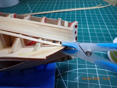

All six glued on inner face and both edges. Eight minutes. Note that the bulkheads were all glued this morning and allowed to dry so that was a time saving that will help me all the way to the end.
As each one comes to be fitted the bow end will be cut to fit the rabbet and the cut end will be dipped in a little glue.
I said no clamps but it seems wise to make sure that the leading end doesn't pop out of the rabbet. There's been no problems yet but I'm nervous because everything is going so well.
I spoke too soon. The last joint on this one isn't keen to stick. I may have been stingy with the glue or it might be the twist. I add more glue. Boil it up with the heater and immediately start on the next stbd one.
The next plank is on and I'm pausing to check that the last port side plank is set. I can wait as long as needed but it's ok so I press on to the end.
The planks tell me that it's time for some gaps. Forcing them would result in buckling. However, they have bent and twisted for me far more than I would have expected. Why? Because I'm heating them as I place them so they are being shaped to fit perfectly without me even realising!
Note that these planks aren't symmetrical. I don't care - they are only there to make a shape for the second planking to look good on.

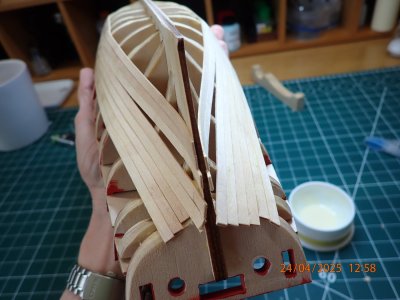

Done. All set hard so I can immediately start making triangles to fill the gaps. (Not part of this time trial though.)
Six planks fitted and ready for the next step by 12:58. I started at 12:19 so that's 40 minutes, give or take the odd unrecorded seconds.

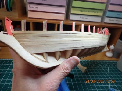

Nine Planks per Hour. Using wet glue and clamps I used to be happy with four per DAY, and overnight setting.
Also, just look at that bow. I was able to align the planks exactly side by side before spot welding them into place, reducing the sanding/scraping time too. (Please disregard the second plank down on the second bulkhead which I shimmed out in error last night due to not understanding the shape of the boat. D'oh!)
There is a problem which the sharp eyed among you will perhaps have noticed. The hull shape is a bit lumpy. That's because the fairing of those bulkheads wasn't done well. Good enough for pirates though.
My method is many times faster, easier, and neater than the 'traditional' way, which means I can build more ships and spend more time on the interesting parts too. Yay!

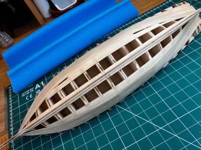

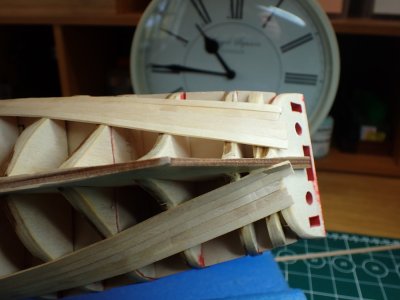

Another hour and a half this morning. Ten planks laid but only four were full length. On the other hand I’ve made and fitted four triangular fillers so I think I’m keeping up my pace.
The hull is very lumpy, like tent canvas stretched over frames. This is because:
a. the wood is so soft, it’s close to balsa so I think it’s basswood rather than lime.
B. I’ve been pressing too hard with the heater between the frames.
3. I couldn’t be bothered to pre-bend my planks.
However, it’s a pirate ship built for drunken pirates by conniving pirate shipwrights so it’s not supposed to be as smooth as Concorde. Ha! Good old ‘good enough’ wins the day!

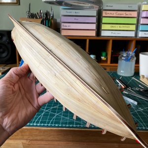

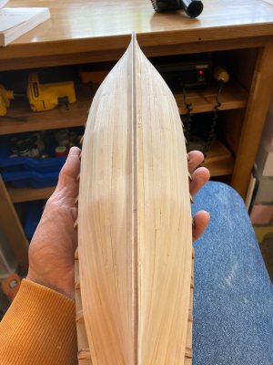

I’ve been scraping sanding and even using a little disc sander to smooth out my bottom. There are still some irregularities where the ribs show through, but it looks a lot better than it did before.
That photograph shows the irregularities a little more clearly. Oh well, I’ll just have to live with it now.

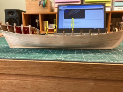

Looks like you got a couple of ribs in the wrong places do you think?
I think you are dead right.
It look as if the bulkhead that has the red arrow should be where the blue arrow is pointing and then the two in between should move up towards the stern.

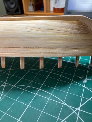

I’ve definitely not helped matters by pressing on too hard as you can see in this picture.
But that’s just occasional planks and wouldn’t explain Le Coquin’s child bearing hips.
I numbered the bulkheads according to the plans. I even numbered the slots. Did I check the numbers agreed before I started splashing glue around? I don’t remember taking that quite important step.
No wonder the deck fitted so badly.
Well, thanks Mike. Now I know what the mistake was perhaps I won’t make it again.

Since there is another layer of planking yet to come, it’s nothing a generous coat of body filler won’t fix.
The Xebec is quite and old ship. Maybe like us, the older ships develop a few "bulges"? Gotta be careful working those bulges off because you can lose muscle in the process. :cool:
Actually I think from memory I might have done exactly the same thing and I thought the instructions were wrong. Fortunately I noticed when I started to plank so managed to overcome the problem with some shimming etc. I am sure you can hide it a bit.
Hi Smithy. Yikes. Maybe worth a go reshaping the hull with poly filler and strips of wood glued to first layer to build up the indentations. I did this on my Bounty renovation - worked pretty ok. Cheers Grant

Detach the planking on the frames with the arrows and put an adequate thickness, this is what I would do. Frank
