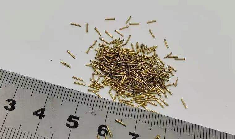

Before I start with the rudder, I just finalized the stops of the windlass, which were still not finished.
These wooden bases for the stops are partly overlapping with the partners of the mast - in addition I made also some "bolts"
and also the two hinges were prepared - only blackening is still not done - fianl installation when everything on the deck will be assembled
these small bolts with round head are from Dry Dock Models - diameter 0,5mm - great to immitate such fixings
a normal toothpick to compare the size - the hinches are "working"

To imitate the bolts with which the wooden part of the rudder were fixed to the hinges I drilled some 0,5mm holes into the brass hinges with 1,2mm width
and insterted once more the fine "tiny nails" from @Dry-Dock Models & Parts
These nail heads are fitting well and looking like the bolt heads.....
overlength removed and ready for blackening
