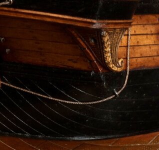

Din62, I was talking about just such a stern on a 74 cannon. The bending of the planks in the stern is smooth, without a steep bend of almost 90 degrees. If this ship has such a stern.View attachment 279615
Yes, it is similar. If you look, you will see my first few boards have a smaller radius, but it is quickly transitioning into larger curves as I add new planks. So it will transition from a square tuck into a round tuck. So it starts with a sharp corner or small radius and transitions into larger more gradual radii. Once I add more planks you will see this transition that has already started. Due to the location of the frame and the square tuck above, it would be very difficult, and in my opinion also not visually pleasing, to go from a square tuck into a round tuck without a transition. I hope that makes sense! ;)
And thanks again for your input! It is always appreciated!
And if you look at your picture, even though it is a larger radius, the first board is almost bent to 90 degrees. Note the board with the eye the rope is going through!
And as you add planks the angle gets steeper and the bend angles are less. It may not be obvious at first glance, but when planking it, it will become very obvious when you are doing the work.

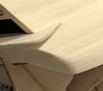

My stern…
Notice the size of the radius after only 4 planks!
It is quickly transitioning into a large radius. ;)
One final note, the size of the radius on the bend doesn’t change the bend angle. It is what it is. ;)
However the size of the radius, relative to the angle of the bend, determines how difficult it is to make the bend!
Here is a pic that shows the angle change as you move downward. Keep in mind this frame is not fully beveled yet.
So the first couple of bends are the most extreme, and they get easier with each subsequent plank! ;)7FE0B5CA-0461-4631-8C9C-FE1F8D365DC2.jpeg

In the upper picture, I am simply holding two different planks to show the angle…it is not one plank. And the frame is not fully beveled yet.
On the lower pic, those planks you circled have a radius in them, there is no sharp corner or crease! Are you thinking the shadow is a crease? I don’t understand? Perhaps I need to take a picture from a different angle? I can sand the radius larger, but have to be careful not to sand through the plank! But I don’t feel that is necessary.
In conclusion, I think there is nothing that dictates the size radius to be used on the bends. I think as long as the hull shape is correct, the size of the bends is not that important. I can’t imagine they could control this with any degree of accuracy in the 17th century! And my stern has bends with a radius. So I’m still unclear what is wrong with it? Because the radius is not large enough? As I said it will become increasingly larger as planks are added lower. So I am fine with what I have, and will move forward. ;)

Nothing wrong with that Dean. Comparing your stern (ok that of your NL ROTF) - to the of the pic of the Prinz Friedrich, the fact that some of the planks on the latter have already been painted black, may create a "confusing" line to the eye. If you disregard the black-painted portion and look at how the whole plank bends, everything gels.
Lol…first of all, my ship stern will never truly compare to what Karl accomplished … ;)
That said, he is considered a master ship builder and carver, and the Prinz Friderich was scratch built from plans. And the Norske Love and Prinz Friderich were 2 of the 3 sisters ships designed by the same person.
Therefore that is as close of a reference to what my ship should look like, than any other ship out there. And if Karl decided to do the bends at the stern that way, without a large radius, then that’s good enough for me! ;)
