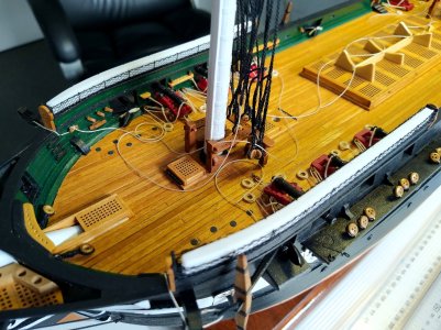

This is my progress since the last log. As yet I haven't fitted the hammock nets, mainly because they are very delicate and I'm very likely to damage them while rigging. I decided to make the lower stays and shrouds first then tie them up after the hammock nets are finished.
I used a simple jig to set the deadeyes.
Temporary riged the deadeyes to get the right tension on the shroud.
Shrouds and stays on the fore mast.
I'll post more tomorrow.
Tony
Tony

This is the first time I fitted nets on a model so it's a matter of trial and error. I tried a few different methods (off the model) to make the hammock nets. I think it would have made the job much harder to do with the shrouds in place.
Tony
Tony

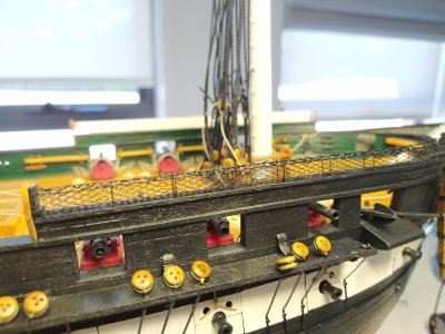

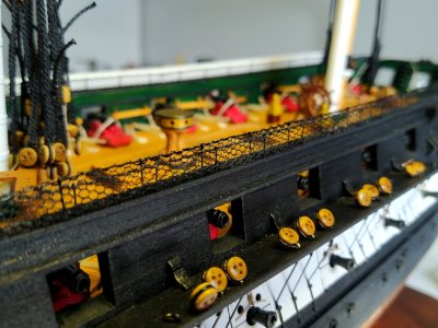

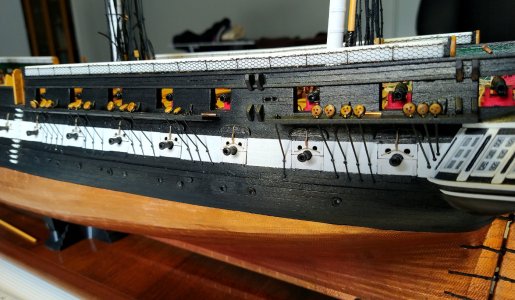

I must admit I have been putting off making the hammock nets until absolutely necessary. This is how I did mine.

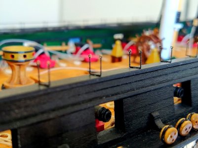

First the easy part fix the PE posts in place care has to be taken as they bend very easily.

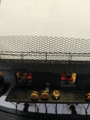

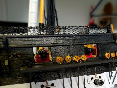

It's hard to see in the photo, first I put the netting over the posts then threaded a piece of 0.3mm wire through the holes.
I used some thread to attach the netting to the wire. When finished I trimmed the excess netting.
Job finished, quite time consuming and very delicate work.

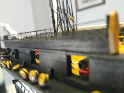

As I was really worried about damaging the nets I made some removable plastic blocks to fit between the nets. These make it a lot harder to damage the netting.
That's all up to date for now.
Tony
Tony
