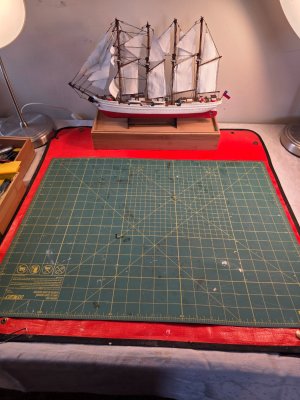

One thing you may want to invest in is a cutting mat. Save the surface of your tables. Legend here on SOS is that a green colored cutting mat is the only "official" one but I have seen others ;)

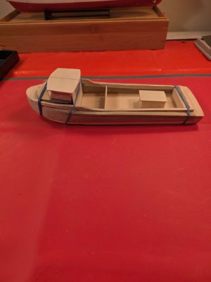

Thanks Rob! When I stain my builds with water-based stains I usually apply 1 or 2 coats of Minwood Pre-Stain. I have made some bad decisions choosing the right primer for wood when the build calls for oil-based paints. So open to suggestions for primers. Interestingly, this build calls for using water soluble wood putty to prime the hull and superstructure followed by a couple of coats of water-based white latex paint. Never encountered that before!
Rob
Rob - Funny you asked...I've been using a green plastic cutting mat but after 8 months of hard modeling, it got pretty cruddy. Tried to clean it off with Goo Gone to no avail. This week I got a red silicon cutting mat that will go on top of my green mat. We'll see how it works!
If I stain the wood, I will definitely stain it first and let it dry well before I apply the shellac. The shellac will prevent the stain from penetrating the wood. (Which is what it does with the water based paints) So I guess you can call it a sanding sealer, or a primer. I usually use water based wood filler (Elmers) when I am doing planking etc. After it is sanded smooth I will prime it. Bryian suggest the use of an automotive sprayable primer/ filler that I will be trying. this is also apparently used extensively to smooth out 3D printed objects.

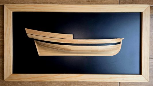

I think I'll be reposting the build log, but in the meantime, I've attached a photo of my half hull. The planking is basswood, the wale was painted, and it was finished with linseed oil.
Nice progress on your build!
Beautiful half-hull model! I love the black plank against the black background. What did you mount the ship on? Is that painted wood or something plastic? It's also an interesting subject...is that a sloop or caravelle? If you repost your build log from MSW I would follow with interest.
Thanks! The frame is pine, the backing is mdf with a lot of sealer applied and sanded smooth before painting, and I used magnets to hold the hull in place. I believe the model is supposed to represent a generic merchant schooner from the mid-1700s.
