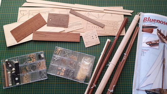

Opening the box was like a few birthdays rolled into one, lots of miniature bits and bobs to admire. The packaging was compact and robust and the parts appear to be of good quality, although this being my first build I had nothing to compare against. This kit is my new normal. The instructions came in disc format and in a myriad of languages, and will use a fair bit of ink to print out. The pictures are colourful and expansive, although I'll bear in mind the advice from other threads that caution against incorrectly referenced ship part names, assembly steps out of sequence, and just simply bad modelling techniques. Either way, it's still game on :)

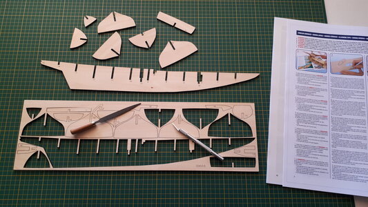

Step one: Remove the laser-cut parts from their sheets and file down any imperfections. My first foray into the unknown with a hobby knife, and it showed. It was a minor injury and a few plasters later before I could continue the process, only now with a bit more respect and a little less blind-minded enthusiasm :p

Just wondering ... can anyone tell me whether it is standard practice to sand the 'burnt' edges of the keel and bulkhead frames? The instructions give no indication, although most images I've seen on the forum suggest that they are. Thanks
This is normal practice. This removes carbon deposits from the laser used to cut out the details. This improves the adhesion of the surfaces and gives the wood a natural look, rather than burnt wood. The cladding will then need to be glued to the frames. And on the bow and in the stern, you also need to remove the edges (small) so that the contours of the hull are smooth. Some instructions do not write this either.

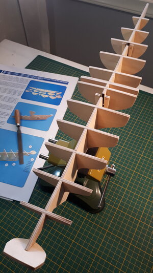

Most of the bulkhead frames were a very tight fit when attached to the false keel. I filed the slots cautiously until a snug fit could be realised, and also sanded the carbon deposits left by the laser cut from the edges as suggested earlier. An initial dry fit gave me a small sense of achievement, although I notice that the tops of some of the bulkhead frames, particularly towards the stern, are not entirely horizontal and have a slight camber to them. It becomes more evident when the stern-end false deck is placed loosely on top and has a small but noticeable 'rocking' motion side to side. Is this a concern? Seems I have a few options; 1) Carry on regardless with the slight curve, 2) Pad the top ends of the faulty frames until they are horizontal, or 3) Sand the top centres of the faulty frames until horizontal. Option 1 doesn't seem right, and the sanding in option 3 might unnecessarily reduce the height of the frame and who knows what knock-on effect that might have? Any suggestions much appreciated :)
The decks are cambered across those bulkheads/beams so that water coming aboard drains outwards and through the scuppers along the sides of each station which will appear on your plan elevations. I recommend securing the bulkheads once placed square and plumb with temporary bracing pieces to secure them before you begin your fairing/filing on the outer edges so that the planking runs smoothly and true without sharp crests or hollows between. You are doing well. Rich (PT-2)
Regarding your transom piece, it is different than my own MS2130 kit where I had to fashion the transom/deadwood our of a solid block of wood. Take another look at your plans and instructions to understand how this area will be executed in your kit. I know that it needs to be solid and not moving around. Rich
Ok, that makes sense thanks Rich. A bit like the camber of a motorway, to drain rainwater. So I'll assume that the false deck, when attached, must follow the contours of the bulkheads rather than the other way around. Yes, my next step is to try and make sure that each bulkhead frame is perpendicular to the keel. Thanks again.
