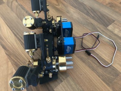

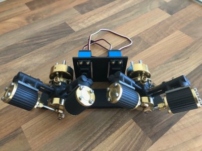

Apologies for my absence. I have been busy both at work and on this model. A lot has been done in the development of the interior layout of the steam plant and I shall post photos in a little while once I have something understandable to display.

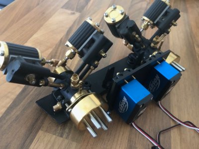

For now here are some photos of the finally painted engine assembly complete with my home-brew designed and machined engine/throttle servo mount.This complete assembly can be removed from the model as a unit for maintenance and is only held in the model by two bolts.
I have gone through the learning curve of bending and silver soldering steam pipework. I have made the exhaust sections to run up to the Steam condenser so far. As I side note I drilled and tapped the exhaust ports out in the engine blocks the same as I did on the inlet to take 1/4 x 40 fittings as they seemed a tad small. no pictures just yet as the pipe "lagging" is currently waiting on the last coat of white enamel
One kick in the teeth, somehow I have lost one of the screws that holds the gland to one of the cylinders,don't ask me how but hey ho. Replacement screw on order from PM Research in Brooklyn NY via the UK distributor.The thread size I know from others is a spurious American size so not simply a case of ordering one locally.I should imagine the screw will only be a few cents so the postage will probably ten fold.
I am taking the engine assembly with me to the model shop tomorrow to find suitable linkages for the servos to throttles. I have seen something suitable online but no sizes are given, believe they are for model aircraft undercarriages so much easier to say "what have you got that fits this?"
The servos BTW are Carson waterproof metal gear CS9s with 9kg of pull.They will get wet and do have to work against the throttle compression sealing washer, hence my choice.
Thanks Bluebeard but I have to say yes and no.Whilst the steam engines themselves and servos are are fairly new to the market, the engine design is probably fifty years old. Everything other than these has been designed and machined by my fair hand and there aint nothing high tech about meROTFROTFROTF
No Cad, drawn on paper with the help of a calculator and machined with no CNC just Vernier calipers as these were made prior to acquiring my new mill with DRO. I can't even claim the prop shaft dog drive principle as mine, it has been around for decades before I was born.
However, I do feel very happy though that everything has worked together, lots to deal with as space was tight height wise and width wise plus the servos only miss the flywheels by a few mm as designed to ensure the servo arms do not clash at their full travel (about 5mm between them, like I say, tight). Contra rotating props mean the servo arms will point towards each other going in one direction, yet to be determined when I steam them. I have servo reverse on my transmitter so that is not an issue.

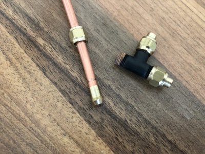

A brief explanation on plumbing production.
Here is a list of what I use;
Copper tube, 5/32" in this case supplied in roll format
Silver solder supplied in rod
Water soluble flux powder
Tube bending pliers
Fire bricks
Rothenberger professional blowtorch
Citric acid in powder form
String
Not shown in the first photo
Plumbing fittings
Cyano glue
White enamel paint
The second picture shows how the pipework joins to the fittings, prior to soldering the nipple.
A brass coned nipple is silver soldered onto the end of each pipe after first sliding on the brass compression nut.
It is basically a case of straightening the copper tube, soldering nipples on each end then pickling
The citric acid powder is added to water in a pan on the stove and boiled up.
The plumbing parts are placed in this solution and boiled for around ten minutes. This removes all traces of oxide, heat discolouration and flux.The parts are then rinsed in water
Too weak a solution and it takes longer, too strong and you have a sticky film left on the parts that comes off with scrubbing in hot soapy water.
Best part is the citric acid is freely available on Amazon and is food grade. Yes I use a normal saucepan for the job !
After cleaning, the parts a "lagged" with string wrapped around their length with the help of Cyano to hold the string in place. I then apply further thin CA to the strung to soak in and firm it up.
Finally the pipe lagging has three coats of white enamel paint applied.
This lagging helps prevent burns from hot pipework when working on the model whilst being operated. It also stiffens the pipework up. Just need to take care that the compression nut can still rotate after doing all this. I found a light twist on the nut with a spanner freed off the paint holding onto it.
The last picture shows the three completed sections that run from the exhaust ports to the steam condenser.

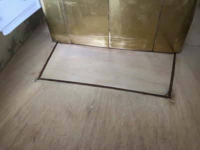

Update as to where the hull is now up to

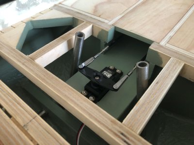

The aft end has been boxed in to provide support to take a 1.5mm ply subdeck as yet unfitted.This includes a mounting for the rudder servo which is just plonked in position for now.Excuse the masking on the stainless propshaft oiler tubes. This is staying put for now as more painting to do once the ply deck is fitted. There are two longitudinal beams to fit outside of these tubes to form part of a combing structure for the engine house which will be removable to access receiver,rudder servo and radio battery.
Supports have been added inside the hull for the boiler and a platform with Stainless mounting studs for the condenser and gas tank. The pink in the pictures is 4 hour fire rated expanding foam. This has been injected in all enclosed compartments to seal everything and offer addition strength. The holes will be cleaned out and filled with wood filler.

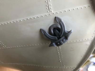

The bow section has been boxed in forward of the boiler which meant installing the Anchors. These are supplied now as a 3D print in the kit and are very detailed. These are bonded and sealed inside the hull as they only sit an inch or so above the waterline.
One massive modification I have made is a section of the deck at the bow is now attached to the superstructure. This is solidly built as the mast will fit into this. This change gives me unhindered access to the boiler twin burners and visibility of both water level sight glass and boiler pressure gauge.It also means the boiler can easily be removed straight upwards as there is insufficient room to slide backwards had it hooked under the deck.Added bonus is that I can install lighting, battery and switch all independently in the superstructure as I was adamant there would be no electrical wires linking hull to superstructure. Also having the mast attached to the superstructure makes the model much easier to transport.
This takes me up to where the model currently stands progress wise. Next on the agenda is to fit threaded studs to hold boiler retaining bands then instal the boiler engines and gas tank to enable me to make up all the rest of the plumbing. I can then take everything apart and finish painting the interior.

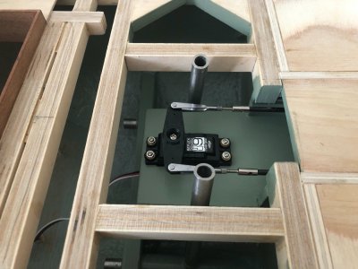

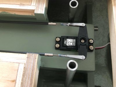

So the next couple of jobs crossed of the LONG list
Rudder linkages intstalled and tested. I used carbon pushrods as these are more rigid given the distance between rudder and servo

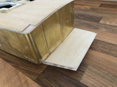

A small update from today's work but I thought I would post it as the aft deck will be on the next updates.
Two birch ply beams have been fitted which act as support for the deck combing that takes the removable aft section of superstructure.Angling the bandsaw table means the tops follow the deck camber eliminating the need to fair the top face of these and ensuring the side faces are perpendicular to the waterline.

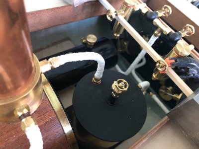

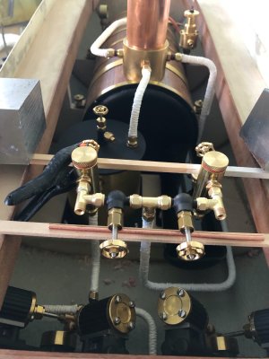

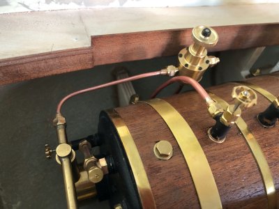

Plumbing,plumbing and more plumbing........
With everything placed in the hull I am in the middle of making and trial fitting all the pipework.
The first picture shows the gas Attenuator valve in position with gas feed to the burners and pressure feed from the boiler using an additional steam valve as a takeoff.
The displacement lubricators are connected to the steam feed pipe via Globe valves. These enable me to shut either engine down and run the other to help with diagnostics. This assembly is temporarily chocked up to enable me to make the steam feed manifolds for each engine at the same time ensuring the gas tank can be removed for refilling and I have enough space for the gas shut off servo.
As a side note the exposed brass of the condenser will be clad in Mahogany as the boiler

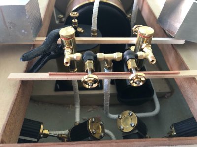

View attachment 517352View attachment 517353View attachment 517354View attachment 517355
Hi Nigel,
Coming along very nicely.
Do you intend to rely on the pipe work to support the displacement lubricators and globe valves or is there going to be some sort of support for that assembly?
Cheers,
Stephen.
