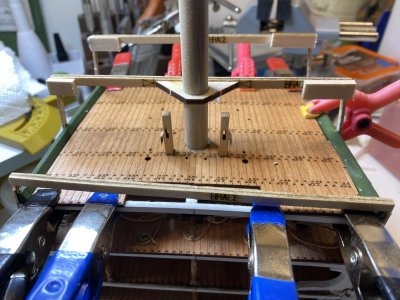

After wasting time with the repair, I fitted the spar deck onto the deck frame. I had to trim one side and I enlarged the hole for the mast. I also made sure the Bitt posts fitted through into the deck below. When all that was done, I glued the deck into place.

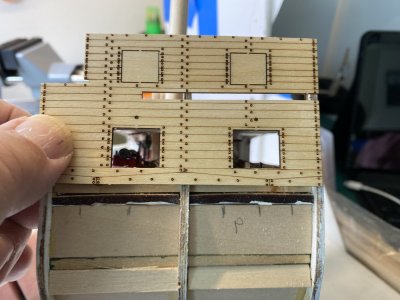

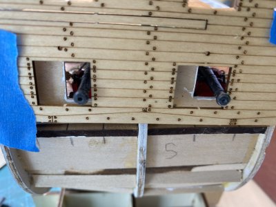

Well disaster has struck the build. I was concerned that the height of the gun ports in the gun deck would not align with the outer frame ports. I took the outer port section and tried to align it with the inner sides of the gun port. They were actually fine vertically but there is a giant mismatch in the horizontal direction. After some study I found the cause. The inner walls of the gun deck are not symmetrical. There are port and starboard sides. There is in the instructions the wording "paint White the port and starboard Gun Deck Sidewalls", but they are not marked as such. With the notching either wall could fit either side and with my luck I picked the wrong sides.
At this point I am truly at a loss about what to do. The outer walls have a port and starboard orientation due to the position of the boarding ladder. I can not really rip everything apart to move the walls. The internal ports could be widened but that will necessitate moving the cannons and cutting through the knee braces. The only really non destructive move I can think of is to move the cannons back and to present the model with the gun ports closed.
View attachment 513733View attachment 513734
Any advice at this point would be welcomed!
Rob
Well, that stinks. Are you sure you can't get the panels off? Could you cut out and patch the panels to get the gun port openings in the right place and then veneer the inside and the outside with strips of thin planking (a lot of work, plus I'm not sure what that would look like on the edges). Can you just swap port and starboard turning the laser etching to the inside and then veneer the outside alone?

I ran into a similar problem with my ST cross section, not making sure lower levels matched the final top level, but since I had to use raw timber on outside I just cut to fit and you only notice if looking hard that ports are aligned wrong.
Maybe you can cut horizontally with fine saw, and scribe vertically to cut from back side (from outside) and then slide the small section over to make alignment correct, being inside lower deck the patch job may not be that noticable.
Many time we are the only ones who know there was a major mistake made in the model, depending on how it is shown on display.
Thank you all for your ideas! I did try to swap the pieces but it would not work, kind of like swapping and turning over gloves. I am going to cut the inner gun ports that are part of the gun deck inner wall. Parts of the knees will come with them and I will have to reposition the cannons. I will use the cut out pieces to patch the other side as Kurt suggests. It will make a bit of mess of the inner side of the gun deck, but hopefully that section will not be looked at too much.

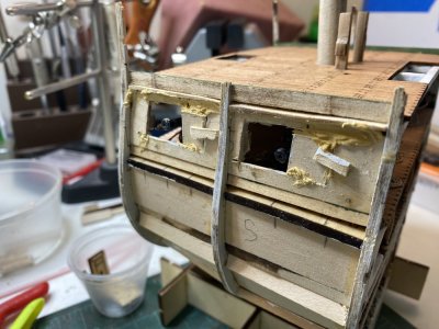

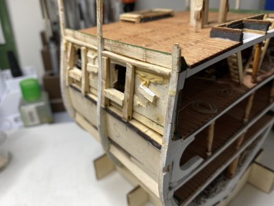

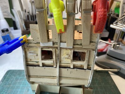

Well I am starting the repair of this problem by outlining the areas that had to be cut out to match the exterior wall. I then used a razor saw and a Dremel with a cut off wheel to cut those sections of the wall out. You may notice I have finally cut off the brace section of the frames in order to work on the spar deck.
I kept the cut out parts to patch the inner wall sections to make the mistakes less obvious. Once the walls were cut the sections fit better.
I spent a few hours loosening the cannons and rearranged them to be more in the center of the new window outlines. I had to reattach and change the lengths of some of the gun tackles. I glued the cut out pieces of the gun ports to the opposite sides of where they were cut out and put some wood filler in the gaps. I also shaved down the pieces I used to hold the cut ports so the exterior walls would fit.

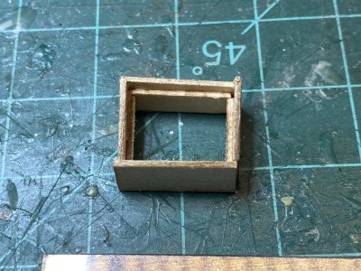

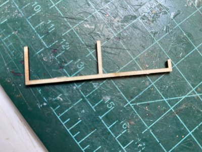

While waiting for things to dry, I started to attach the main hatch which goes towards the rear. If you examine the instructions there appears to be some variation in the main hatch frame. The first photo does not show a middle piece of the hatch frame while the others do. When I fitted the hatch frame there is a gap in the middle part of the frame where decking is missing.
To make up for that I glued a scrap piece of 1/16th inch strip onto the frame.
I then glued the frame into place.

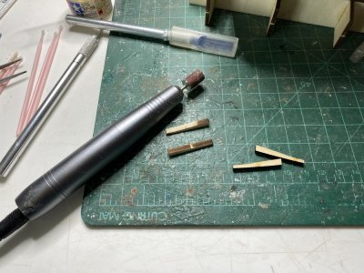

The interior braces for the gun ports were then sanded prior to putting them into position. I have been using a "nail drill" that is lightweight and works very well as a mini drum sander. It is a very inexpensive tool that I highly recommend!

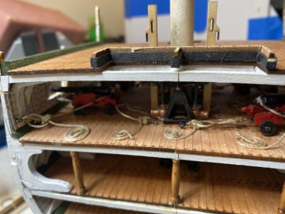

I was concerned with the placement of the cannonade pivoting bases along the side walls. Some build logs suggested these were placed too high and had the cannons pointed sky high. I assemble the cannonades and placed them with pins upon the bases. They appeared to be in a fairly good position and angle and I decided not to move the bases.

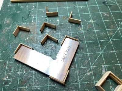

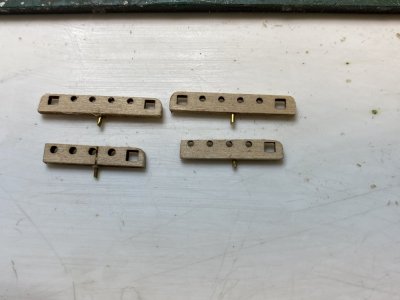

The instructions would have you insert pins in the laser cut bits to look like axels in a sheave. But I followed the work of Tom Culb and glued small rounded pieces of 1/16" scrap that I colored black in place to represent the sheaves. To be honest it is doubtful anyone would even notice.
I then laboriously cut two slots in the bit to place two cross pieces. I started by marking the approximate length. I then drilled 2 holes on the top and bottom of the slot I was going to make. Using a sharp blade I cut out the area between the drilled holes. Once I enlarged them enough, I was able to use a very small diamond covered file to get the holes to the shape I wanted and but in some 1/16 X 3/32 " strip. It was after that that I discovered that I had placed the slots 90 degrees from where they were supposed to go! :mad:
