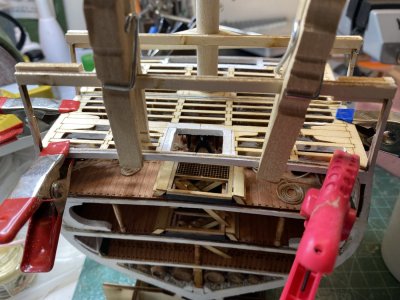

Some of the braces I was unable to clamp using my regular clamps. As I have stated in other building logs I have used clothes pins which I 'Flipped over" to make longer more controllable clamps. These worked well here.

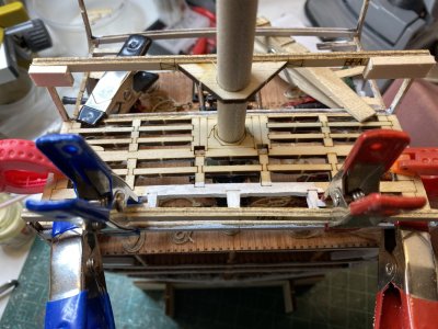

I then glued the rear part of the spar deck frame into place. It went in with minimal modification. The altered clothespin clamps were handy to clamp areas that needed a longer length clampIMG_9879.jpeg
