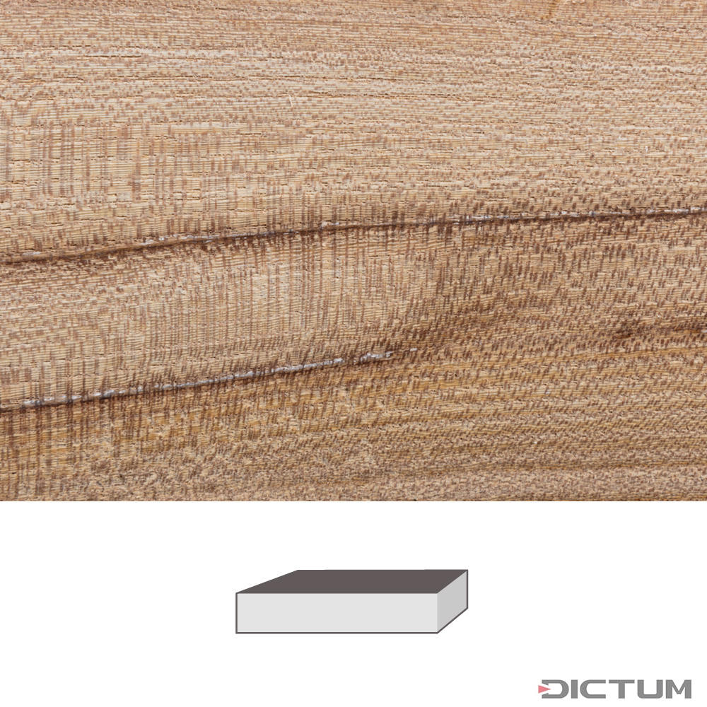

I will post a picture of the room where the "magic";) will happen, including my stock of pear wood. At the moment I am searching for some maple wood for the decks and hope to find some boxwood for the ornaments.

Hi Maarten
I can't seem to find it in my close environment so ordering via internet will be the solution. Thank you for drawing my attention to this webshop.
Thanks Maarten
I live in Spijkenisse, in the Rotterdam area, so both 'Fijnhouthandels" are an option. Mid April I have a few days off and might pay one of them a visit, otherwise I will order from Dictum. For now I am working on the gunports and before actual planking the deck will start I still have to make stairs and a servant. So mid April will be well on time.
I know that the Arnhemse Fijhouthandel also react to orders just asked them and explain what you want. On their facebook they mentioning this to order from their houtzolder and sent a message.
Thanks Maarten
I lived in Capelle for 8 years but don t know a specialty shop in the Rotterdam area. If you go to Arnhem I would certainly recommend to also visit Baptist, the candy store for every woodworker.
Yes, Baptist is well known. Years ago I ordered a fine set of chisels from them, but I've never actually been in the store.
