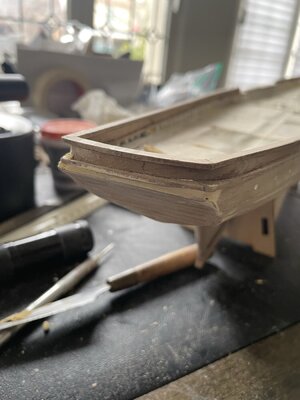

The hull sanded and filled. More sanding to do before painting. For painting, does anyone have any tips for painting the thin white border along the water line? I'm thinking I don't have quite the talent for that.
There are various ways leading to Rome.
One option would be to first paint a wider than necessary white band, followed by taping off for both black and red. Another option is to paint the black and red areas above and below the waterline and applying a thin white tape as your waterline, I think these tapes are available for car trims.
Wow Phil. You have been busy and made excellent progress. I agree with you on the waterline - a challenge for me as well. I think pinstriping the waterline with tape is an excellent idea!

Pinstriping car-tape is a good option. It’s tin and in a variety of width.
When you want to paint, a little ad-on of Johan’s paint option:
After the wider band of white, tape off the above part of the white and further to below and paint the black above the waterline.
Then tape of the lower part of the white and the black and paint the red beneath the waterline.
