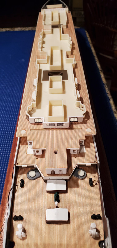

The instructions say to build the upper decks off the ship and then attach as an assembly. I have thought about it and can't see any good reason for this. It is a problem trying to attach all these warped parts in midair so I attached the promenade deck to the ship. This has at least taken some of the warping out of at least this deck. Now at least I have something somewhat straight and solid to work on. I guess I'll find out later if failure to follow instructions comes back to bite me lol.
Thanks. Well I got one warped boat deck wall on the ship and it fit pretty well. I have to tie everything together when I get the other one on and then get the boat deck on. I have to admit I had a sigh of relief that this went on straight. Once I get the wood deck on the boat deck and attach it progress will really slow down. Lots of things to do up top as far as photo etch etc. 42 Boat Deck Wall 1.jpg
Today was a day of setbacks and mistakes. This top deck is the flimsiest of them all and I messed up trying to get the wood decks on it. The wood decks need a lot of trimming and I thought I had it set to go. I applied the glue and it wouldn’t sit right. So I’m trying to nudge it over while the whole deck is flopping around and I somehow got a tiny bit of glue on my thumb and smudged the printing on the wood deck. It is going to have to stay that way as I think whatever I could try would just make it worse. Unfortunately this is the top deck. Wouldn’t you know all the decks that are now covered are pretty much perfect.
I also forgot to sand off the raised lines on the plastic deck underneath the wood which I think may come back to bite me in the future if the wood starts to lift. Finally, I cut back the edges of the wood deck needlessly in certain spots as there is no channel on part of this deck for it to have to fit in. So the most visible deck is the one with the most errors by me. It was also not able to clamp it down as I have been because it is so thin that just it being elevated by the clamps was bending it like a piece of spaghetti causing the wood to lift. It was just one of those days.
I said it was going to be a practice/learning project and I just have to accept it as that and learn from my mistakes. Time to move on and not let it upset me too much. It’s like a new car that gets a scratch though, my eye goes to it whenever I am looking at it! Maybe I’ll stick a bench over the smudge or something.43 Setback Smudge.jpg
