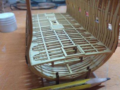

Orlop installed and completed, and now onto the gundeck. I'm assembling it in stages to try to prevent the creaping problem during the orlop assembly. It is much more fragile due to the gaps left at the edges where the additional knees will be installed. I'm also using the jig Tom of all Trades devised for the assembly. Works very well. Thanks Tom.................................
Orlop completed.
I'm still not convinced the 'sandwiched' deck method is best. I see the benefit, but alignment is very difficult and always leaves a dark line between the two layers. I've tried to disguise it in places, but sometimes it just gets worse. I would have preferred a solid deck moistened with water and clamped in a press/former.
I left some gratings off because the hatches look nice. Gundeck beams are in the process of glueing and I plan to install tomorrow. Following that be able to ascertain the gunport height and begin thinking about remaking the gun carriages to look heavier and a little more authentic...............................
I see your point, however, since the deck beams are not milled from solid into a curved profile, it is the glue line that helps to maintain the curve of the deck.

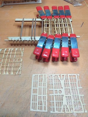

Gundeck pretty much completed.
The included jig works reasonably well for placement. I'm using PVA almost exclusively, which does cause thinner pieces to curl up and require clamping.
At least I am now able to ascertain the gunport height above the deck and start to think about creating the correct pattern carriages.
Gratings yet to be added. If any areas looks a bit empty after the deck fittings are installed, I'll prop up some of the gratings to fill the spaces, as suggested by Gunther.
