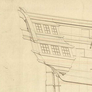

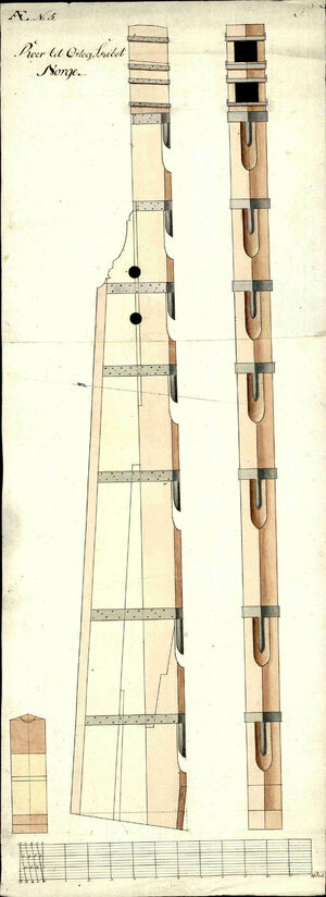

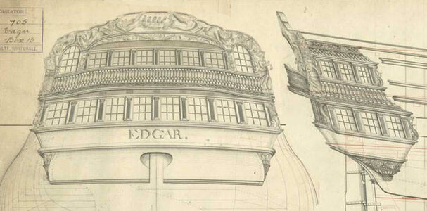

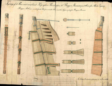

Here are the contemporary drawings from NMM
it shows that the lower two pintles are a bit longer than the two top ones, It is interesting to see, that the middle pintle is longer than the two top ones but shorter than the two lower ones, unless it is just an optical illusion.
For what it's worth...Antscherl (writing about swan class ships) says that the straps were 3 inches wide and the pintles were 9 inches long except for the lowest pintle which was 11 inches long (and the recess for the lowest pintle was likewise taller).
And the pins are beveled at the end to the shape of the bottom of the recess. 'Parallel sliding'. It's all in the details!
PS: Beautiful drawings! The more you look at them, the more you see.
