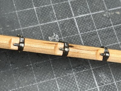

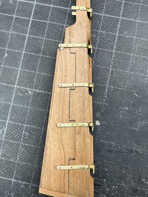

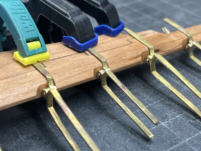

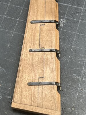

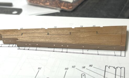

Before I went further with the hinges I made some "clench bolts" with which the back piece of the rudder was fixed

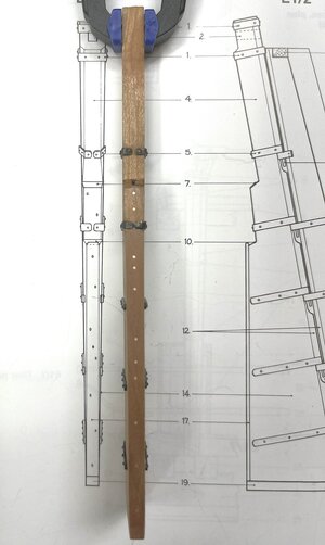

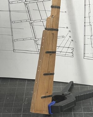

a frist dryfit
I still have to widden the "score", so that the rudder can be installed later on
from this perspective the form of the rudder can be seen
with the drilled holes for the "through and short bolts (dia= 0,5mm)
the same with adjusted lengths

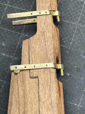

Next work is the blackening
Many Thanks to @Mirek and @BradNSW for the kind commenst and all others for the likes and also the visiting my building log

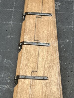

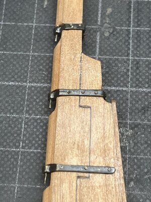

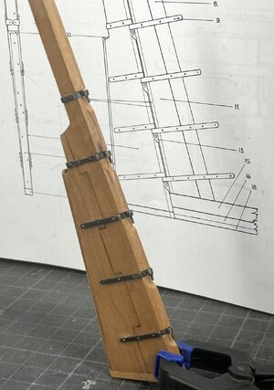

Blackened and dry fitted (still without the bolts)

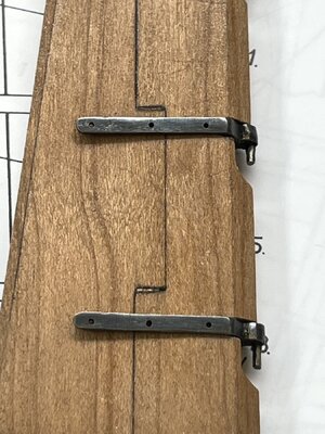

and now several detailed photos of the "bolted"

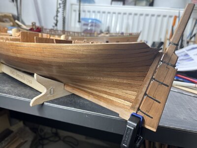

and how it is looking when later installed at the hull

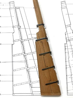

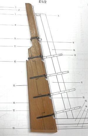

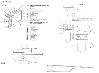

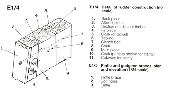

Happy belated Birthday. Are the Dwgs that are shown laying rudder on from the Anatomy of the Ships books or is that a Dwg from the kit… CAF? Many thanks and great build.
