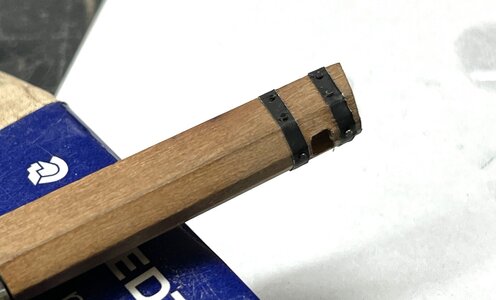

A final work was still necessary on the rudder blade
above and directly under the mortice for the tiller were two additional braces installed, both in deepenings in the wooden post

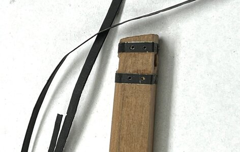

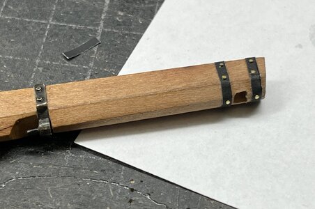

So I was able to use first time this black metal foil which I bought some weeks ago - many thanks once more for the tip
The foil was caut into strips with a sharp knife and fixed with superglue - holes for the bolts are also already drilled
These tinny little bolts from @Dry-Dock Models & Parts are installed (head has 0,6mm diameter)
and afterwards blackened with a small drop
many thanks for your interest ..... to be continued with the work on the gudgeon braces of the hull ......

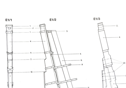

The gudgeon braces of the hull are started
for some information before the related sketches of the Anatomy book
