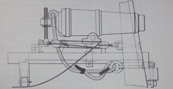

I believe they were 8 poundersAssuming her armament was all 32 pounder Carronades, based on the drawing from Dupin the running tackle blocks were likely about 6" long. The rope would be about 2" circumference and the breech rope would be about 5 inch circumference. There is good information on tackle for long guns, but I have never been able to find definitive data on Carronade rigging. If anyone can share a source on this information that would be great. I could not find info in Falconer, Dupin, or elsewhere in other than drawings, so far.

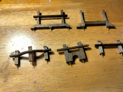

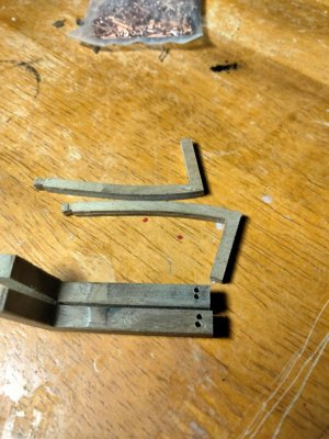

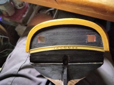

Drilled theView attachment 517092 holes in the cats heads and assembled the bumpkins.
I can't seem to get accurate spacing. Need an x,y table

Made up a scriber and that improved my accuracyI make pilot holes with a scriber or a needle mounted in a paintbrush handle. They help to keep the drill from wandering.
