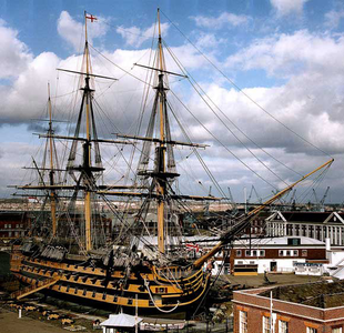

That being said, who knows if the current Victory at Portsmouth is rigged anything like the original? And your first try at it looks much better than my first efforts.

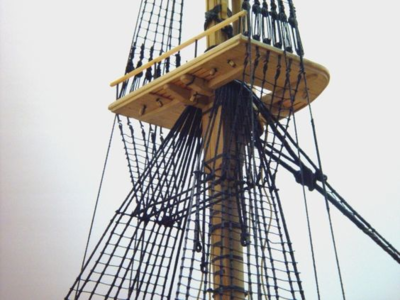

What kinds of problems did you have with the futtock shrouds? I remember going through several iterations of methods of fitting them. My first ship had them go through the regular shrouds, sheave together to form one line, and attach to the deck eyelet. The next ship had them attach to the shrouds at a bar going horizontally across the upper part of the shrouds. The first method looked cool but probably wouldn't be accurate for your ship. (Mine was the Constitution.)
The firs is a model and the second is the current iteration.

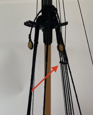

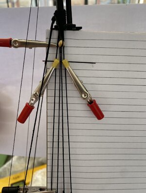

Good afternoon. As discussed with Vic, I’m attempting the top mast futtock shrouds in despair.... this site is for my good and at time pretty sad attempts at building the Victory.
I do know by fitting some of the parts needed without the mast installed will be way easier on the main and foremasts.
Here we go:rolleyes:

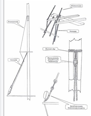

This is how the are supposed to go :
My morning of fighting with this Lady..

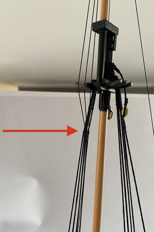

I firstly measured the ratlines spacing per instructions to ensure correct placement of the futtock strake. I used 0.2mm to lash it to shrouds.
Then the issues...self explanatory. The red arrow below I accidentally cut the top lashing of the stern shroud Sick. Blue arrow I couldn’t get the lower strops(for better word) in line and all the whippings just came out untidy.
And to finish of an amazing morning of rigging it pulls the shroud slightly out...I was super careful to get the tension correct...clearly not.
I guess we got to have these days. Funnily looks rather good when looking at it from a whole...ship building.:D
Cheers Grant

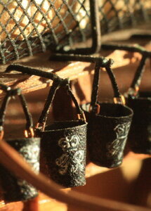

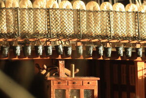

Have checked out the HMS Victory by Manfred Burkert? The search would be victory and Cirdan. Cirdan is Helmut who shared this incredible scratch built ship with us. I think there’s also a link to a German site that includes more pix. Examples:
View attachment 303836View attachment 303837
Good morning Vic. I have seen this of his model. It is simply out of this world. A special individual and modeler for sure and he certainly deserves all the accolades he received and some more.
40 years....not on my agenda for sure. Thanks for sharing this.
Cheers Grant

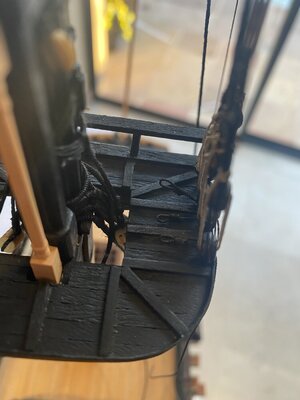

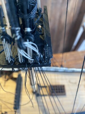

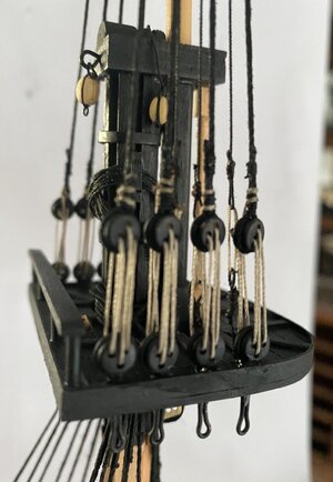

Good morning. While I was showing all my blunders yesterday I thought I would share another- my thread I use for the shrouds is from Mantua and it “frays” baldly when working with it. I run a flame through after working on an area e.g. fitting futtock strake and this works wonders.
Anyway yesterday-as I said was one of those mornings and I spilt candle wax on my Mizzen crowsnest. Had to break the stern most strop and using a small blade and some 800 grit sand paper sticks To work it off. Repaired- you can see the futtock shroud strops connected to the dead eyes- got these more in line (not 100%) but better than the starboard side.

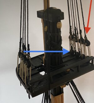

View attachment 303806View attachment 303808
Cheers Grant

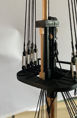

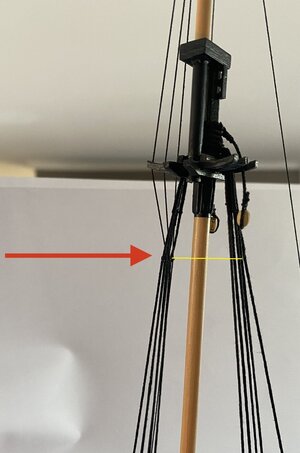

Grant, good afternoon. I am still a long way from this stage, but in this place serveny screws were installed to prevent stretching of the guys. Shown with a yellow line.C7EF6399-4942-46E9-9815-6E57FFE8146A.jpeg
Yes my friend - some days are like that - we should just stay away from the shipyard. Sometimes a bit of distance is all that is called for to see things in a brand new light. Enjoy your few days in the Wilderness.
